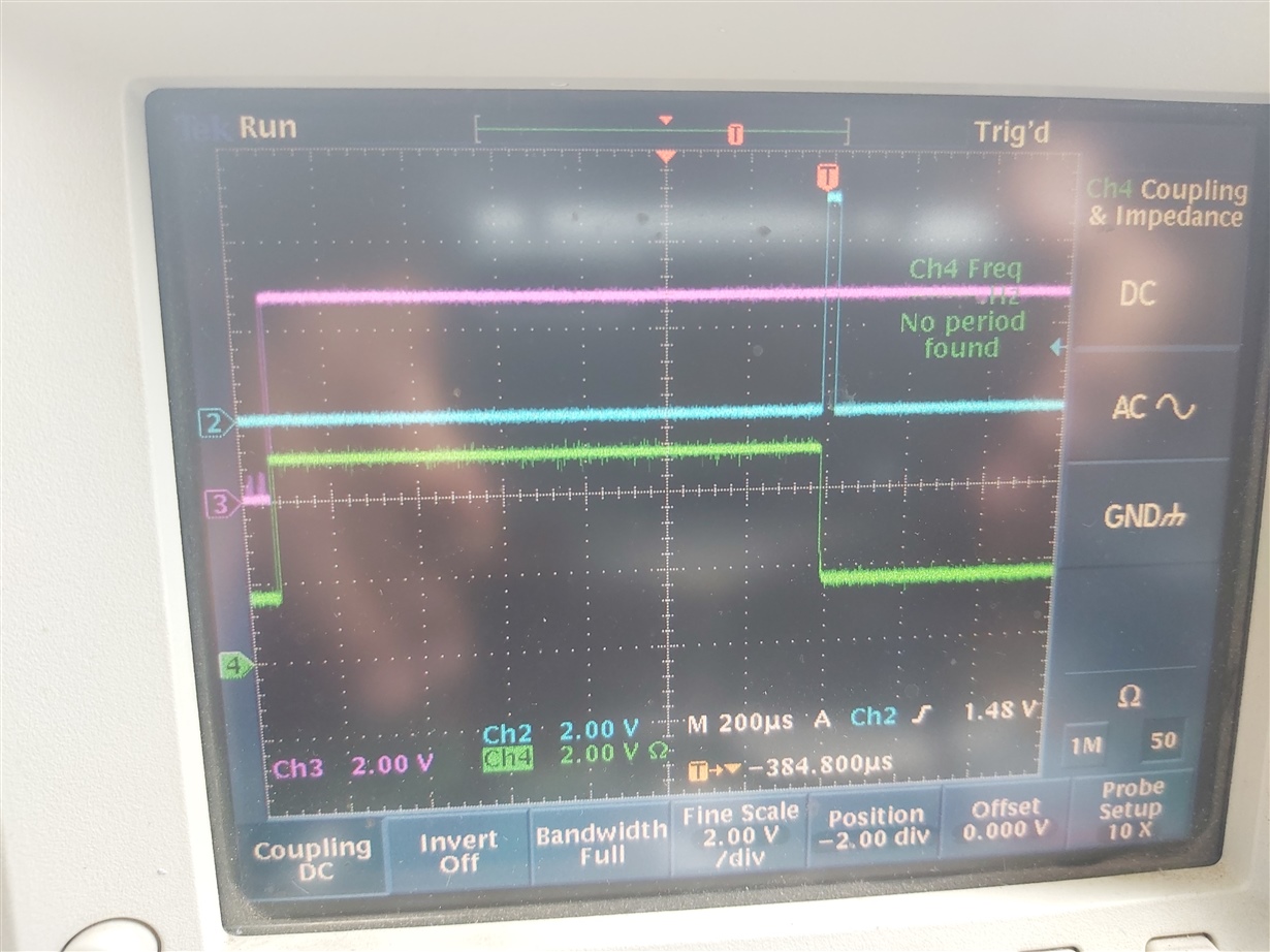

  • I apologize for my late response I was on a weekend break.
    I attached the two inputs: COMP_IN, SIG_IN.
    I did not attached the PC2_OUT because the measurement affects the signal. Logically the circuit works fine .I expected the difference between the phases to be zero and this is not the case, even though I get the desired frequency

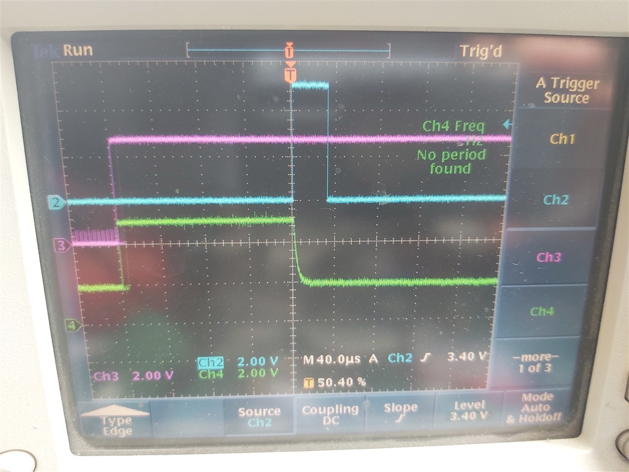

  • What happens when you connect the PC2 output to the scope? I wouldn't expect much change for that node with a high-impedance scope probe.
  • I attached two pictures of the measurement of the signals.
    The first with Prob X10 and the second with Fet Prob (Referring to the photo in the previous email)
    You can see that there is an effect of the probe, also you can see that the circuit logic works correctly
  • The 10x mode of the scope probe adds a 9 Mohm resistor in series with the internal 1 Mohm resistance of the scope, so you can expect some variation in the signal with that.
    It looks like the PC2 comparator is doing what it's supposed to do - it is high impedance at the start of the plot, allowing the voltage to hold at ~2V (from the capacitor), then forces the output high to charge the capacitor a bit, and finally releases the line again, leaving the capacitor at about 2V.
    I think you're seeing fluctuations in the phase due to the slow response time of the loop filter.
