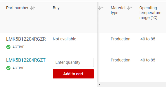

  • The operating temperature is -40 to 85℃, it may not suitable.
  • Hi user3756530,
    Again, I stress that the datasheet does not actually list an ambient temperature rating. There is only a recommended junction temperature range (-40°C to 135°C). We have to put an ambient temperature range on the product web page to help sort it in the table search, and 85°C is a common maximum rating for industrial applications. But for the reasons outlined in my prior post, the operating temperature range listed on the website is not a good reflection of the actual valid ambient temperature range for the device.
    To demonstrate the artificial nature of the ambient temperature range on the web page, consider the following example. The LMK5B12204 has two analog PLLs and four output banks, and the output banks can be operated at 3.3V. If the customer tries to use both PLLs and all four outputs at 3.3V on a 4-layer board, the worst-case power dissipation is close to 2.7W, ΘJA in the datasheet for a 4-layer PCB is 23.3°C/W, and at 85°C ambient the junction temperature is 85 + 23.3 * 2.7 = 146.8°C, which exceeds the recommended maximum junction temperature by about 12°C. It's not that the part isn't suitable for 85°C operation, just that some use cases require better thermal design: more board layers, lower voltage to the VDDO rails, or lower-power output formats could reduce the junction temperature increase to acceptable levels.
