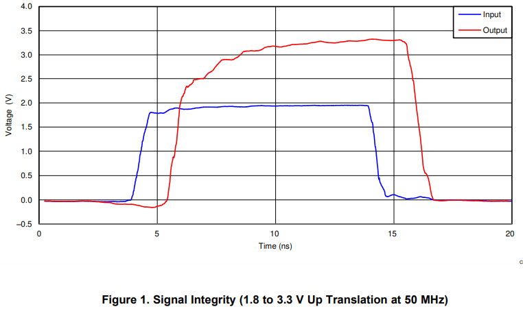

    Here's an example of operating an LSF translator at 50 MHz under fairly ideal conditions:
    You can see here that even if the pulse width were cut in half, the output would still reach ~3.3V, but the integrity would be less than ideal.

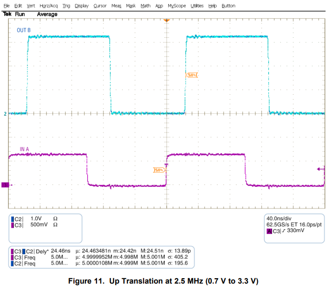

    I don't have a 50 MHz waveform from AXC for a perfect comparison, but you can see the difference in this 2.5 MHz waveform pretty easily:
    The down side to using this device is that it's not auto-bidirectional, so you would have to control direction for the data signal.
