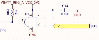

Team, working with someone on this device. The datasheet indicates that “Outputs should not be pulled above VCC” but once VCC=0, there can be a voltage on the output. Their implementation (shown below) has a pull-up on the output (VBATT=3V3). During operation, VCC_3V3 will shut down, and VBATT will remain high. Will this short period that the output exceeds VCC during shutdown cause any damage to the part or any other issues?
