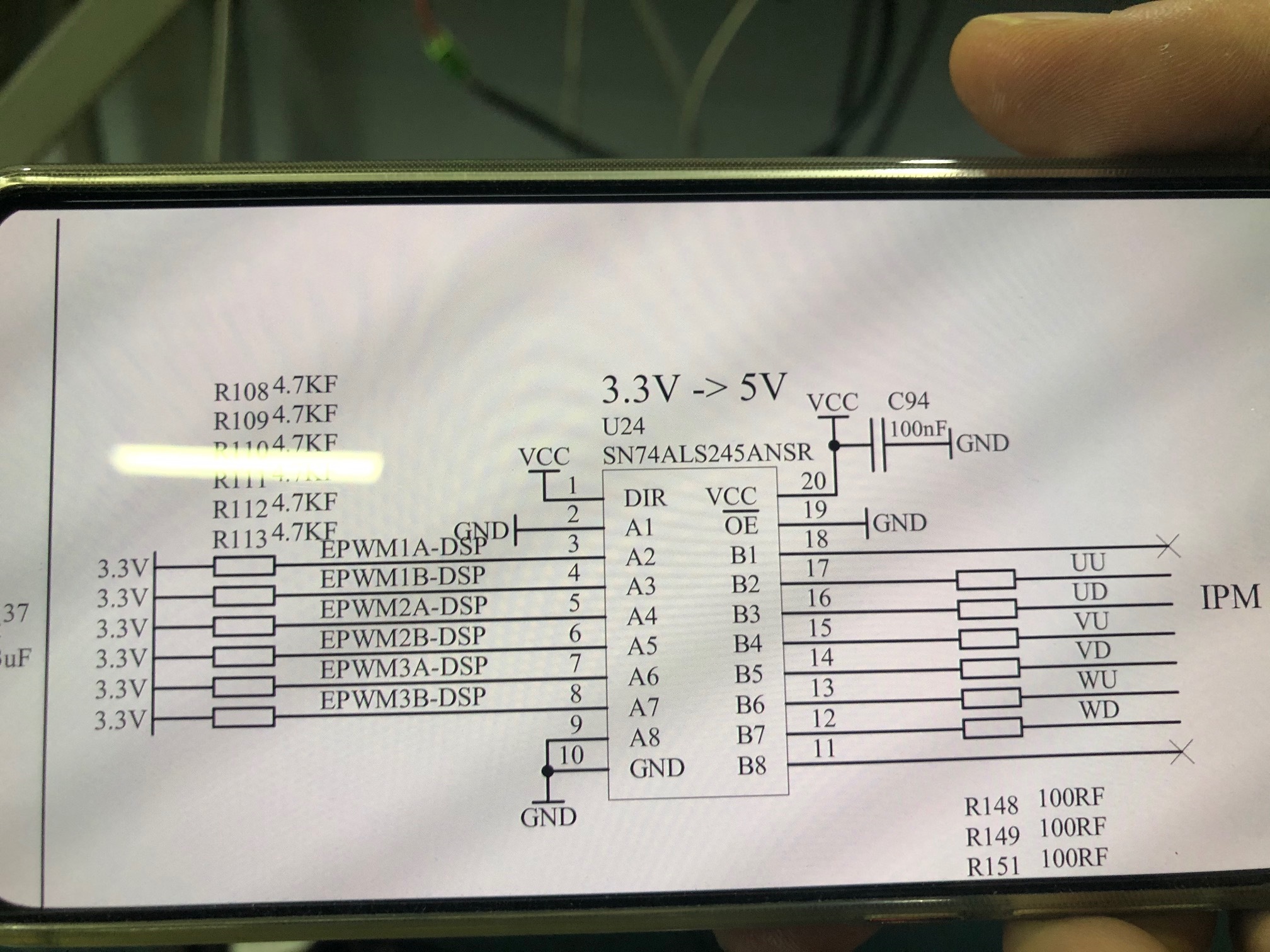

Hi team,
When applying SN74ALS245ANSR in buffer, sometimes there would occur output all high level issue and such issue goes with the IC during ABA swap test. See below schematic, see if any advice to better improve.
