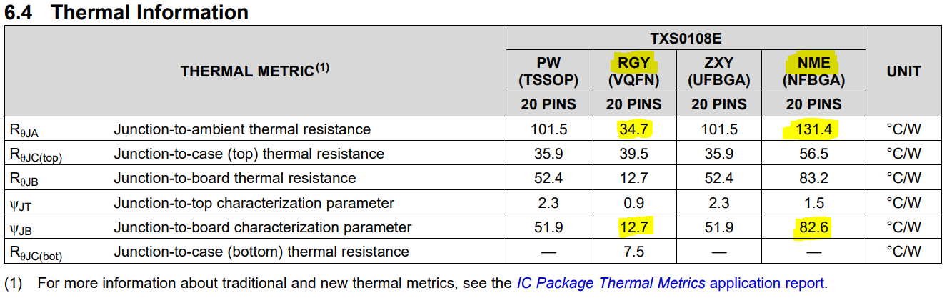

Hello team,
Could you share the data of Junction-to-ambient thermal resistance for the RGY pkg with no vias ?
Thank you and best regards,

Hello Tanii-san,
The junction-to-ambient thermal resistance, RθJA, is determined assuming only basic solder connections to a standard board and no additional heatsink.
If you are attempting to calculate thermal dissipation through the bottom of the device with added vias, use RθJC(bot) in combination with your heatsink's thermal properties.

The datasheet includes complete thermal properties for the device assuming normal connections (no additional vias, heat sinks, or other means of thermal dissipation):
R_θJA (junction to ambient thermal resistance) of 131.4 (NME) is larger than 34.7 (RGY). This indicates that for 1 W of power consumption, the RGY package will increase in temperature by 34.7C, and the NME package will increase by 131.4C.
131.4C is larger than 34.7C. Therefore the RGY package is better at dissipating thermal energy than the NME package.
Similarly, ψ_JB (junction to board characterization parameter) indicates that the RGY package has a better junction to board dissipation characteristic than the NME package. You can see this in all of the thermal values listed.
Adding vias to the thermal pad will increase the thermal mass and improve the RGY package thermal dissipation by a small amount. Adding vias and a large ground plane on the opposite side of the board will significantly improve the thermal dissipation. As I have previously stated, this device does not use very much power, and this is most likely not required. I would need details of the application to help make the determination.
The TXS0108E uses very little power in general, however this is dependent on the device's operating frequency and loading. The static power consumption is only dependent on VCCA, VCCB, ICCA, and ICCB, however dynamic power consumption depends on operating frequency and capacitive load.

We got back the results for the thermals if the thermal pad is not soldered to the PCB:
Result- Theta JA-High K (standard datasheet value): |
84.8* |
Result-Theta JC, top (standard datasheet value): |
40.5* |
Result-Theta JB (standard datasheet value): |
51.0* |
Result- Psi JT (standard datasheet value): |
2.3* |
Result- Psi JB (standard datasheet value): |
50.3* |
Result-Theta JC, bottom (standard datasheet value): |
7.3* |
