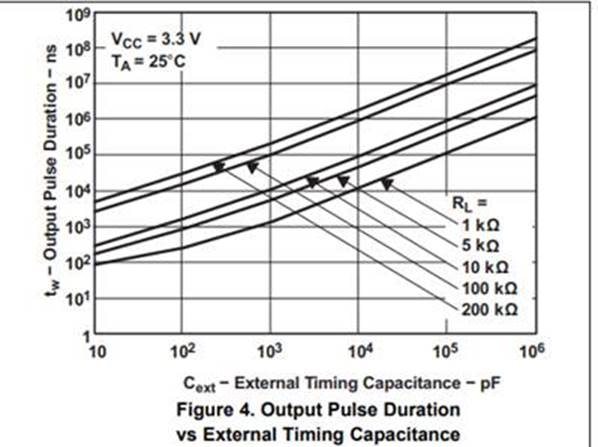

The customer want to design the output Q-Pulse which over 500ms. The Vcc voltage is 3.3V.
They tried to use 200k ohm of Rext and 4.7uF of Cext. The result can match their design.
However, maximum value of Cext in the diagram of DS is only up to 1uf. Is there any concern to choose 4.7uF of Cext with using this part? Thank you.
