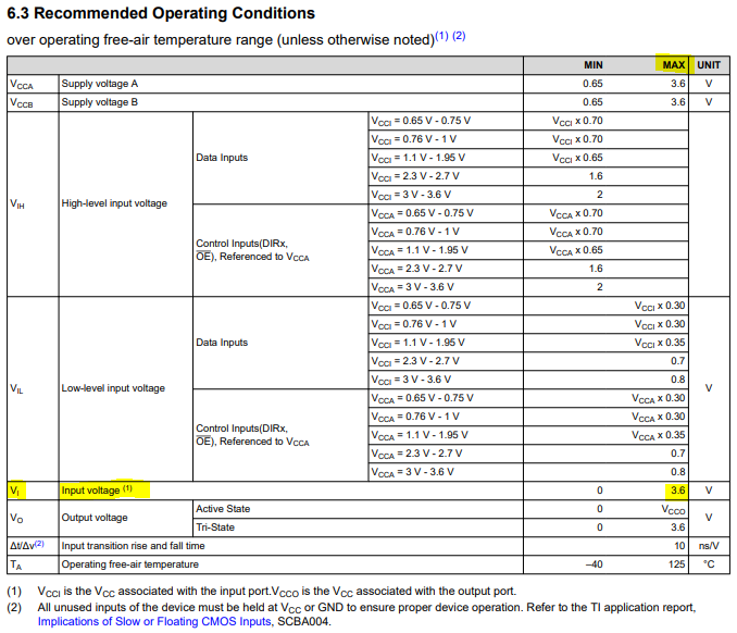

SN74AXC4T774: Applying 3.3V control okay?
Part Number: SN74AXC4T774
We have this as a logic translator from 1.8V to 2.5V.  We have a 10k pull up from the OE to the 1.8V (on the VCCA line) as per the data sheet.  We are using 3.3V logic to drive the OE.  It appears that this is not an issue but wanted to confirm that applying a +3.3V control or OE on this part when VCCA is +1.8V and VCCB is +2.5v.
