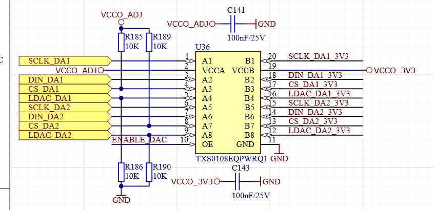

I'd like to interface from 1.8V to 3.3V domain using the TXS0108EPWR.
I assume a maximum frequency of f_max = 50MHz.
The AD-converter I intend to control is a AD5541.
Will the TXS0108EPWR a good choice to do this job?
Are there any alternative parts for this case?
There are no pullup nor pulldown resistors inbetween TXS0108 output and the AD's inputs.
