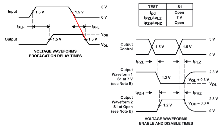

The first question is that does the output voltage level equal input level? Fig. 1 is from the PARAMETER MEASUREMENT INFORMATION part of
1.      SN74CBT3257 Mux / Demux
2.      SN74CBT16292 Mux / Demux
and these contents are the same in the documents of these two devices.
From the left of Fig. 1, if seems that input’s 1.5V, which is half in the rise between low and high, is the same in output. So does this suggest that these logic devices keep the output voltage level the same as input voltage level?
II.
The second question is on the right of Fig. 1, in which I don’t understand what the curved shape mean. In the dashed box on the left, the transition is straight; why on the right it is a smooth curve?

  • I.
    Yes  the output will equal the input until it reaches Vcc-1V. Then it will be clamped. So if you have a 0v to 5V siganal going in and the Vcc is 5V then the signal coming out will be 0V to 4V. If you have a 0V to 3V signal going in then the output signal will be 0V to 3V.
    II.
     The curved shape is used any time you go into a high impedance state. It shows the output floats.
