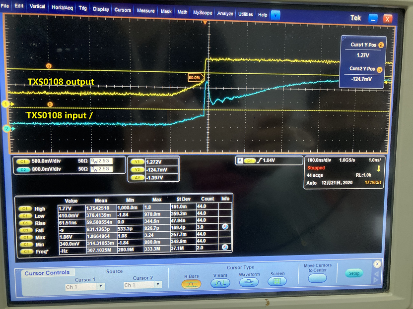

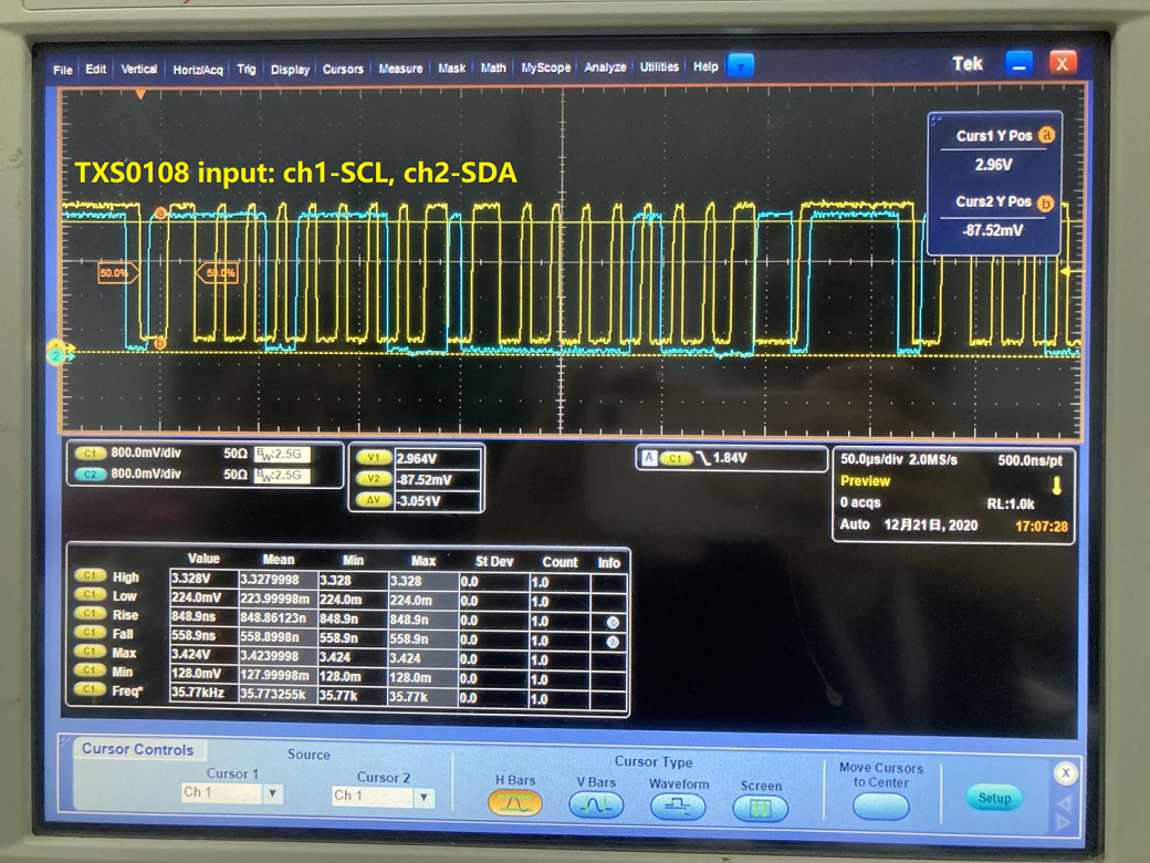

Hi team,
My customer try to use TXS0108 to translate I2C bus, 3.3V to 1.8V. But don't know why TXS0108 input signal has a voltage spike, as shown below.
From the waveform we can see that TXS0108 regarded the spike as high-voltage.
My customer are worried about the spike, could you please estimate the spike influence for TXS0108? Will it affect I2C communication?
