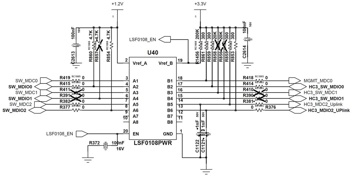

Here is the schematics as below;
line A1-B1 and A2-B2 are for MDIO Clause 22.
and line A5-B5 and line A6-B6 are for MDIO Clause 45.
we think that there is no problem on A1-B1 & A2-B2 CL22 line.

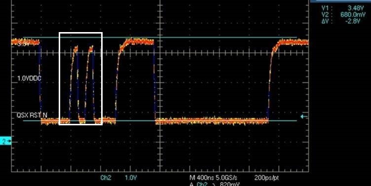

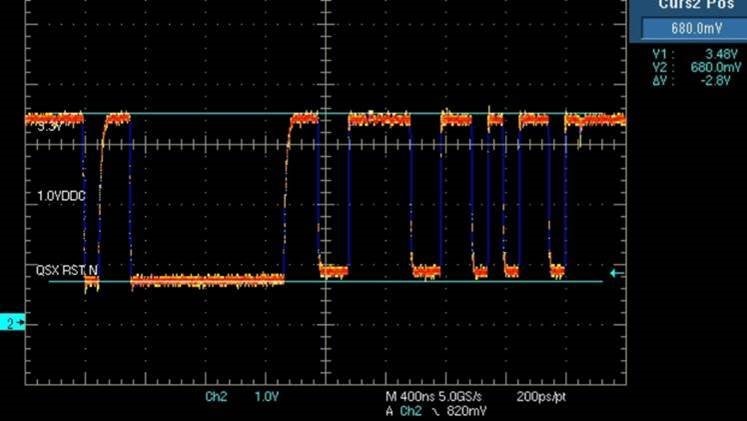

here is the pulse sequence on B2 pin below; (MDIO Clause 22)
but there is some problem in CL45, the high value is little low, and rising edge is lslow. (I remarked it in white box)
First I doubted pullup resistor on B side, we already tested 200 ohm, 250 ohm, 300 ohm.
the symptom was similar, just attaching 300 ohm pullup resistor showed best pulse sequence.

1) please review the schematic.
2) please let me know if there are any modifying points in schematic for improving this symptom.
3) please check that this LSF0108 device is suitable for both MDIO CL22 and CL45.

    I would recommend to remove C1121 and C1122. These are likely the cause of the slow edges. Just doing a quick calculation, the expected rise time (10% to 90%) of a 300 ohm resistor + 1nF capacitor would be 660 ns (2.2 * R * C), which appears to be pretty close to what your scope shots are showing.
