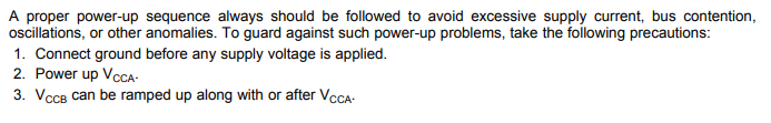

In the datasheet there are some power-up considerations:
 I’m using this component with the direction from B to A and VCCB rises before VCCA. It’s working good.
I just wanted to check if I work with opposite direction, so in stages 2 & 3 above “VCCA” should be replaced with “VCCB”, right?

    I would recommend the power sequence be followed independent of the DIR pin state.
    The key thing to note is that all I/O pins have inputs that are always connected, so if any of the I/O have a voltage that is not driven to GND or VCC even during power up or power down, then there is possibility of excessive currents due to shoot through.
