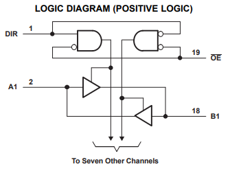

Can you please let me know the number of gates and the number of transistors used in this IC.

    I'm afraid I can't share an exact count (ie one from our design files), however I can give you an idea of the number of transistors and gates based on the datasheet.
    The device is rather simple internally, with the block diagram provided in the datasheet:
    Given the above diagram, you could say that the device has 18 logic gates (16 x 3-state buffers and 2 x 2-input gates).
    CMOS gates typically take 4 transistors to implement, so the quickest estimate would be 4*18 = 72.
    Usually for reliability estimates, I'd recommend to use  "less than 100" transistors as the count.
