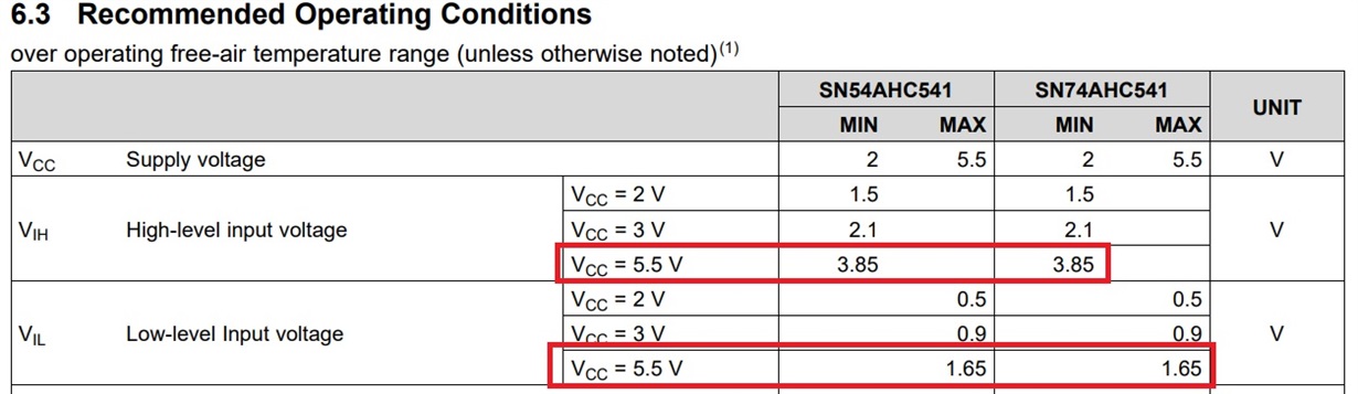

Hi All,
I have a question about SN74AHC541.
Please tell me the values of VIL max and VIH min when VCC = 5V.
Ishiwata

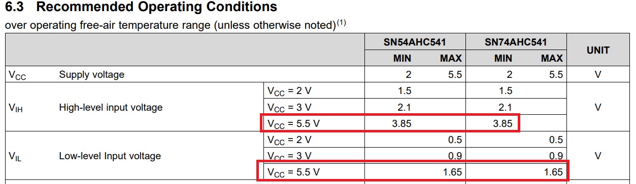

Hi All,
Ishiwata
Anyway, it's simply 30 % and 70 % of VCC.
