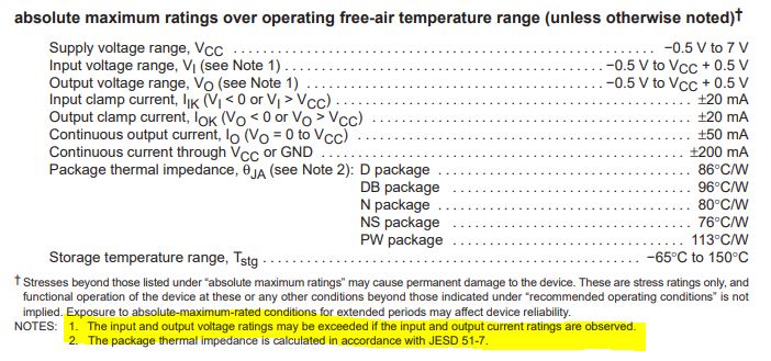

SN74AC14: Acceptable overshoot/undershoot level in short term
Part Number: SN74AC14
Hello team,
I've heard that the TI's standard logic devices won't be guaranteed but may works with large VOS/VUS such us VCC+1V for 10ns from logic FAQ.
So, do you think if the OS/US duration is 5ns, the 2V OS/US will be acceptable?
