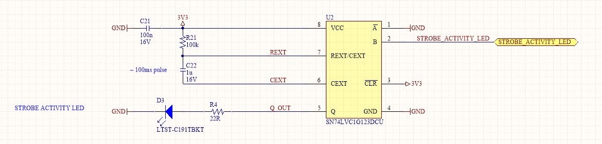

SN74LVC1G123: Make LED Light stay on for a 100ms after trigger rising or falling edge
Part Number: SN74LVC1G123
Dear *,
we want to give a LED a fade-out is the SN74LVC1G123 a good choice?
optoelectronics.liteon.com/.../LTST-C191TBKT.PDF
Can we direct drive the led from the output of SN74LVC1G123? or do we need a mosfet?
Is it ok to use 10k and 10uF for 100ms ?
