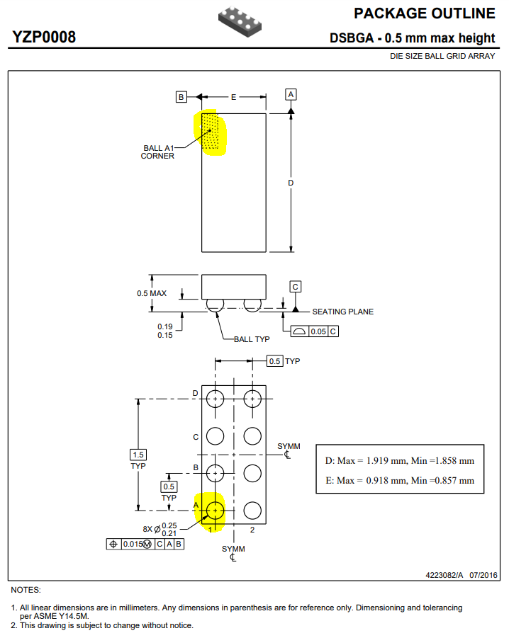

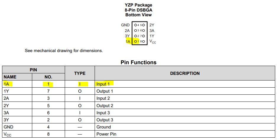

What is the pinout of the SN74LVC3G17YZPR BGA?
The datasheet is very vague! The table on page 5 lists pins from 1-8, but BGA drawing near the end of the datasheet shows the typical A1, A2, B1, B2... notation.
Page 5's BGA bottom view doesn't show any orientation marks, so it could be 180 degrees rotated and would look the same.
Showing bottom view in pinouts is a good way to insure that people make mistakes when generating PCB footprints.
It's a very poor datasheet.
