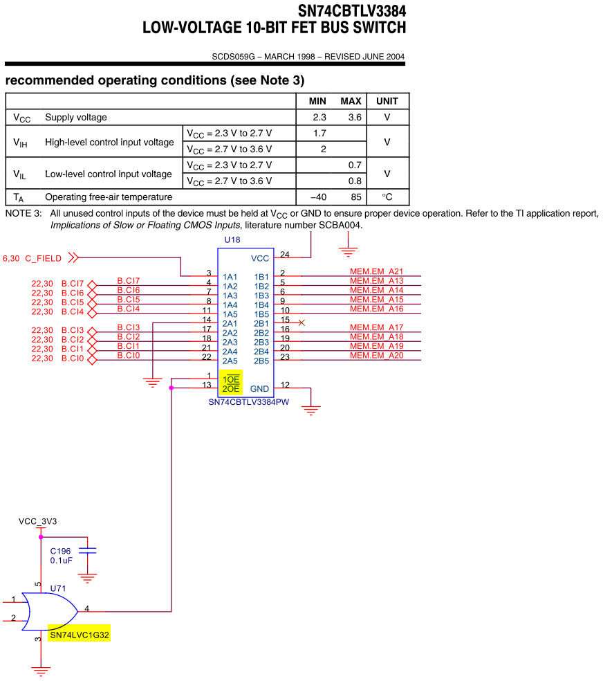

Hi All,
I would like to ask some questions on SN74CBTLV3384 switch.
I have found that on sheet 15- EMIF Muxing page of the schematics of EVM6437 (made by Spectrum for DM6437 DSP),  the OE# pins are controlled through an OR gate, rather than directly.
The first question is what should be the voltage for OE# signal? Does SCDS059G’s VIH and VIL include OE# signals, or only for input port A1 and A2 signals?
The second question is that why the OR gate is used?
Zheng
