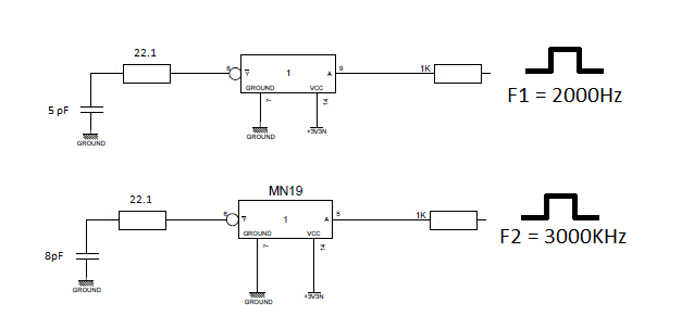

Our customer would like to confirm the power consumption calculation of SN54AC14.
Here's the customer schematic below:
As this component is composed of 6 inverting gates, They would like to know if the calculation must be done for each used gate?
Then does the total power dissipation result in the sum of each value?
Please let me know if you need clarifications with the customer.
