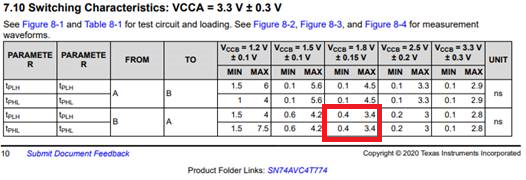

My customer is looking for a low latency device to level convert from FPGA 1.8V output to 3.3V.
Frequency range is from 24Hz to 148.5MHz including clock signal.
Q1, She have designed with reference to datasheet rev.E which describes TPLH,TPHL=0.2ns (min) to 2.9ns(max)
However the latest datasheet rev.F is changed to TPLH,TPHL=0.4ns (min) to 3.4ns(max) at
( VCCA=3.3V, VCCB=1.8V, B → A case)
Are there any method to get rev.E spec device for the customer? ex) screening etc?
Q2. Do you have other recommend device for this usage other than SN74AVC4T774?
Datasheet Rev.E
Datasheet Rev.F
