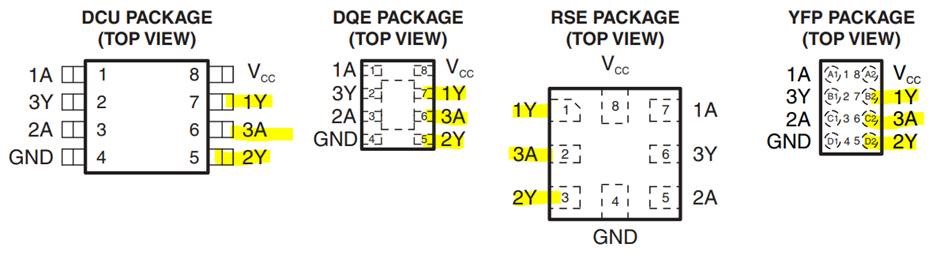

Team,
I noticed the SN74AUP3G06RSER (RSE package) has a different lead/pins configuration than the other packages of the same part number.
Just want to confirm it is correct since it looks they could be mirrored.

Yes this mirroring is intentional.
