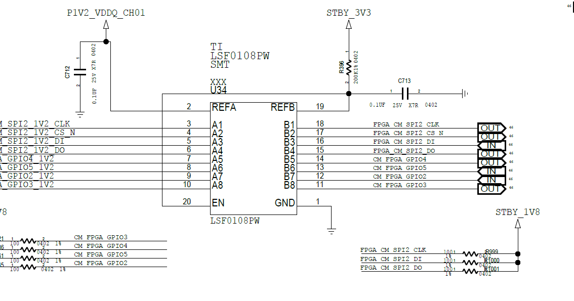

Hi team,
Could you pls help to review the LSF0108 schematic? It is for the 30MHz SPI application,1.2V to 1.8V.
An connect to FPGA without pull-up resistor and Vref_A=1.2V;
Bn pull-up to 1.8V with 100ohm and Vref_B=3.3V.
I have checked the schematic following the design procedure on the datasheet and the schematic looks good to me.
Really appreciate it if you could double check the schematic.
