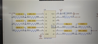

We are using SN74LVC07A and configure as SPI level shift, schematic shows as below. VCC is 3.3V and using 5V pull up power at output side.

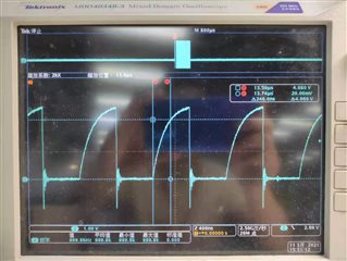

we set the data rate to 1MHz but find the waveform seems distortion, we remove all output components except pull up resistors but seems nothing change. Is it normal here?

    As for your waveform, is this an input or an output? Could you attach a waveform of both an input and an output? If the waveform is an output, you're likely not able to source current fast enough through a 4.7kΩ, and I would try using a 2kΩ resistor instead.

    The pull-up resistors, together with any parasitic capacitances in the circuit, form a low-pass RC filter. The waveform shows that the resistors are too large for 1 MHz signals. You can use smaller resistors, but this will increase power usage. For this reason, open-drain devices are usually not used for level shifting of fast signals.
    There is no single device that can handle all five of these signals well. To convert 3.3 V signals to 5 V signals, you can use any buffer with TTL-compatible inputs, e.g., SN74AHCT125. To convert 5 V signals to 3.3 V signals, you can use any buffer with overvoltage-tolerant inputs, e.g., SN74LVC2G34.
