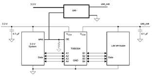

Dear Sir/Madam,
Please help to confirm with TI TXB0304 datasheet of the Ioff below as per spec table below.
Does it means the leakage current?
With application circuit below, the highlighted red above in the table is it correct leakage current for our case?
And for highlighted red above, A port mean for 1 port leakage or total A ports leakage?
Which leakage is suitable for our case from the spec if above highlighted leakage is not for our application circuit? Main reason for asking, we have the send the part for FA and the result is NO fault found.
We have having 50% rejected rate due to high leakage current during off mode. The VCCA always supplied but VCCB is off during system sleep mode. And we can seen the high leakage current in our product. Can you advice any issue with this connection?

  • I did cut the trace of 3V to VCCA,  and the leakage current become normal and replace new level shifter,  the leakage current become normal too .

    I can't really say for sure with the limited info provided. It is recommended to power down both supplies at the same time in the Power Supply Recommendation section which is likely to avoid a state such as this. You didn't say or not the state of your OE pin, is this being driven to a valid Logic state (specifically Low)?
    Right below the Icc spec:
  • Hi..
    Yes..Our OE is driven low and VCCB is low. We do have external PD resistor on OE pin.
    For our case,  VCCA always powered,  OE = low,  and VCCB is 0V. From your spec stated in Ioff there,  the supply can be switch off either VCCA or VCCB = 0V as stated snapshot extracted from the spec. Am I interpret correctly?
  • Hey Wee,
    Yes, you are interpreting the spec correctly. The top row is for the VccA = 0 V case and the bottom row is for the VccB = 0 V case.

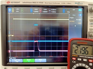

  • Hi Dylan,
    Please see the attached picture.
    Setup condition:
    3V to VCCA
    OE with PD resistor of 100KR
    1.8V to VCCB.
    3V, OE and 1V8 probed at scope and 3V connect in series with a multi-meter to the VCCA. you can see that the result of 3V always powered, OE and 1V8 is always low but the leakage is ~220uA. We have confirmed that root cause is come from the TXB0304.
    Let me know why the ICC got so high leakage current when OE and VCCB is low.
    Can you help to ask your FA team to check with this condition for the 3x failures units that we have sent to her?
    Because her first FA report cannot duplicate the issue.

  • Hi Wee,
    I wasn't involved in the FA process and not sure who you are referring to, but typically the process involves a lot of testing to determine if there is damage to the device. This seems to be a specific state of the device with the configuration you have it in which is likely why no issues were found during the process.
    Is this 220 uA present until VCCA is powered off or until VCCB is powered back on?
    As for the table, I would remove the last row since the supply for VccB I assume won't be supplying any current when powered off.
  • The lady is from Shanghai, China and her name is Tricia,  Is there possible help to inform for the test again.
    The 220uA leakage current will goes to off when VCCA powered is off.

  • Hey Wee,
    Its recommended to power both rails down due to there being a potential floating node internal to the device causing a slight supply increase. This is likely why powering off VCCA fixes the issue as well. Powering down one of the supplies will disable the I/O, but there's also a potential supply current increase from not powering down both supplies. Due to the architecture of this translator, its ok to leave the A port floating.

  • Hi Wee,
    I didn't perform the testing so I'm not going know to what you are referencing for the FA test. As for the high current draw you are seeing, this is likely due to you powering down the VCCB while leaving the VCCA supplied. This can lead to a potential internal float which would result in high supply current. The way to avoid this is to power down both supplies as recommended in the data sheet. The impact of the internal float will vary over process.
