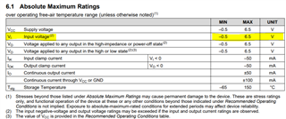

Usually, we can only find min VIH in datasheet.
How can I know the tolerance of VIH?

This will be specified in the abs max table as the max Input Voltage.
Rami
Hi Rami,
Actually, I want to know the tolerance of Vt for standard CMOS input buffer.Usually, I can find Vt+ and Vt- in schmitt buffer datasheet.
But I can't find any information of Vt in tandard CMOS input buffer datasheet.Can you help me?
