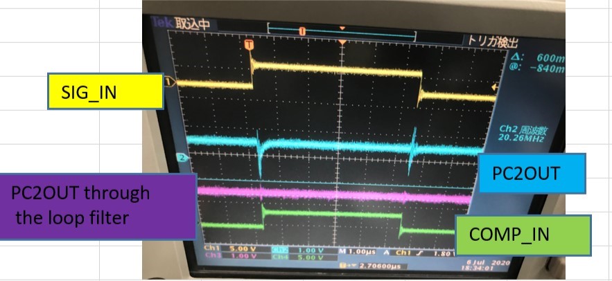

  • Hello Kato-san,
    I think I may have misunderstood - I thought you had not yet built this circuit.  Are you saying that this circuit is already built and is not working properly?
    If so, can you share oscilloscope shots of the input and output signals? Pins 3 (COMP_IN), 13 (PC2_OUT), and 14 (SIG_IN) should be sufficient.
  • Hello
    thank you for your reply.
    I have already built this circuit.
    It is not working well when i use 'LRCK' signal as one goes to COMP_IN.
    I send you the signal image.
    BR,
    Taku Kato
  • Hello Kato-san,
    It looks like COMP_IN and SIG_IN both are getting multiple triggers due to ringing on each clock edge, which is likely what is causing issues. Since this is an edge-triggered phase comparator, each edge will change the state of the output and can cause it to fail to lock.
    It also looks like there is a great deal of noise in this system, which also could be a factor.
    It also appears that SIG_IN and COMP_IN are exceeding the device's absolute maximum rating for input voltage (Vcc + 0.5V)
    You could attempt to clean the signal with an RC filter at the input - I would start with values of 22 ohms and 22 pF to prevent slowing the signal edges too much while still providing some ringing reduction.
  • Dear Ermrys-san
    Thank you for your reply.
    i set INH Hi, and use snubber circuit, it works well.
    thank you for helping me.
    BR,
    Kato Taku
