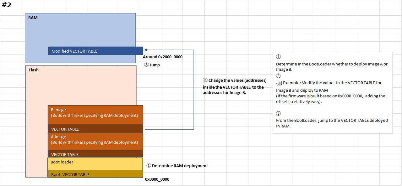

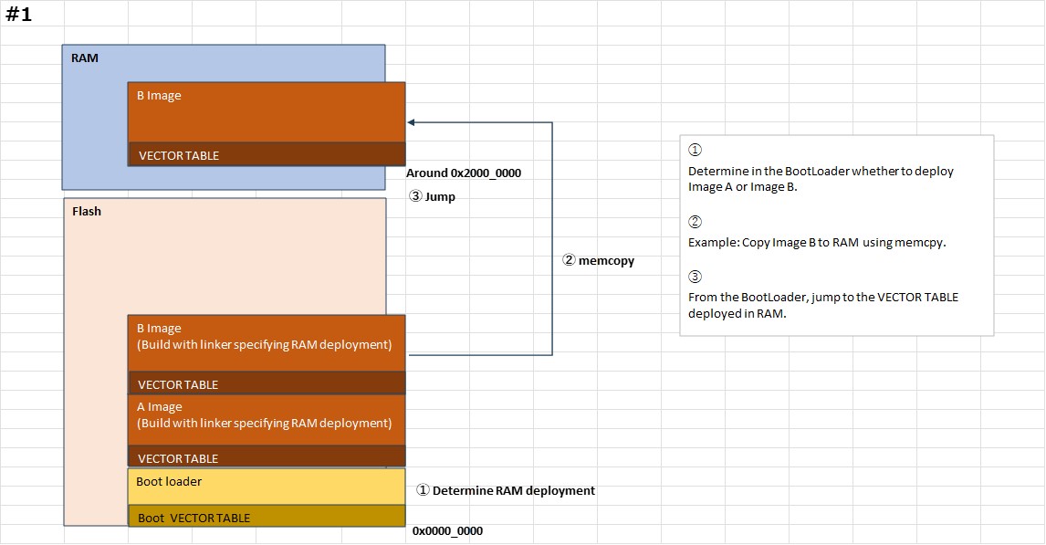

Hi experts,
As shown in the diagram below, my customer are considering a configuration where the Flash memory area consists of two images (A and B) and a BootLoader, and the selected image is deployed to RAM for execution.
Q1: Is #1 and #2 feasible?
Q2: If it is feasible, could you please let me know any constraints or concerns?
Q3: Also, could you suggest if there is a better approach?
Additional information / Purpose:
- The goal is to enable firmware (image) switching during operation in the field by deploying to RAM.
- Currently, it is undecided which image (A or B) the user will use, and also undecided which image will be updated during an update process.
- Two sets of table data will be prepared to match the images, and these will also be deployed to RAM.

  • Hi  ,
    Why you need to deploy one to RAM for execution?
    For #1 yes, the image B can execute in RAM while  #2 is not, only put the vector table to the SRAM.
    What you need to care about for #1 is that make sure your image complier is based on the RAM address. For example, the vector and other project of image B project is already based on 0x20000200(for example), you can not sure project staring at 0x0000 as the image B.
  • Hi ,
    Thank you for your reply.
    The above is the reason. At the moment, we have designed it to be flexible.
    Let me confirm the above. Does this refer to the compiler's Section settings? If I specify a RAM execution area at the Section settings stage (e.g., ImageB=0x20000200, ImageA=0x20001000), does this mean that ImageB cannot be executed anywhere other than 0x20000200?

  • Hi ,
    Regarding item #2, I have a correction and an additional question.
    The procedures in steps ①–③ are the same. The term "Modified VECTOR TABLE" in step ③ refers to the address of the VECTOR TABLE located in the Flash region that execution will jump to afterward.
    My intention is to make this "Modified VECTOR TABLE" variable, so that the jump destination can be freely selected between the A Image and B Image.
    I am using the sample code located at:
    C:\ti\mspm0_sdk_<version>\examples\nortos\LP_MSPM0G3507\boot_manager
    as a reference, but in the sample code the jump destination VECTOR TABLE is fixed.
    Is the above approach feasible?
    O.H

  • Hi O.H
    Sorry for late reply. there might be some errors in E2E email notification.
    There is no flexible as I can see so far for RAM execution. Why you don't want to execute in Flash?
    Yes. You will compiler your code for imageA/B in compiler, right? And this will fix which address to store your function (e.g timer interrupt handler)? And All the interrupt handler address will in noted in interrupt table, CPU will execute and enter into the related address.

  • Hi O.H
    You can not choose which image you need to execute through vector interrupt table. You need change change your PC address to execute different main function. The advantage of storing the interrupt vector table in RAM is that you can freely modify the addresses of each interrupt to jump to a specific interrupt in ImageA or ImageB.

  • Hi O.H
    Yes.
    All is used in absolute address.
    But good news is that if you simply place the interrupt vector table in any location in RAM, you only need to put the table's address in the SCB->VTOR register. When an interrupt occurs, the CPU will jump to the interrupt vector table and obtain the address of the interrupt service routine.
    If you want to use a single interrupt vector table for both image A and image B, then during the switch, you will need to modify the entry addresses of the interrupt service routines in the interrupt vector table. For example, if image A's timer handler is at 0x2000 and image B's timer handler function is at 0x4000, then when switching from A to B, you need to change the timer interrupt address in the interrupt vector table to 0x4000.
