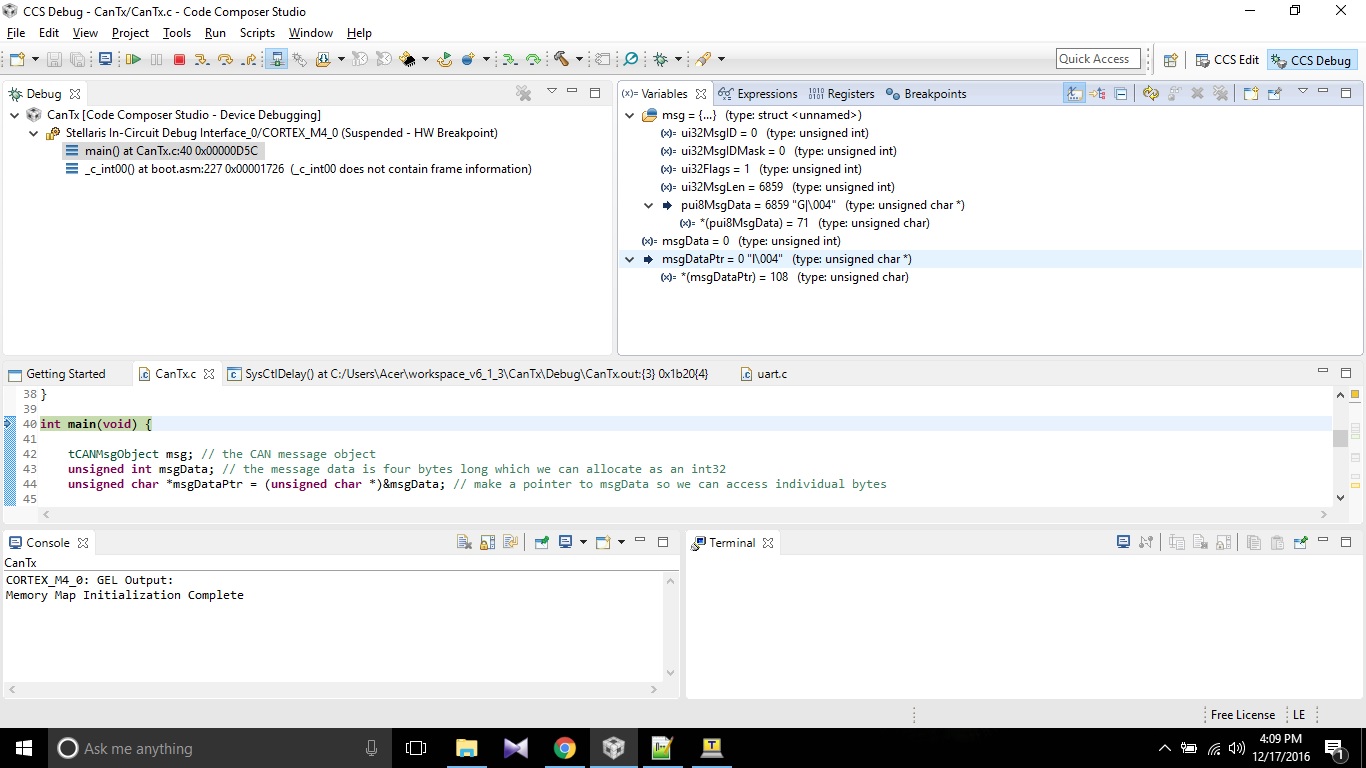

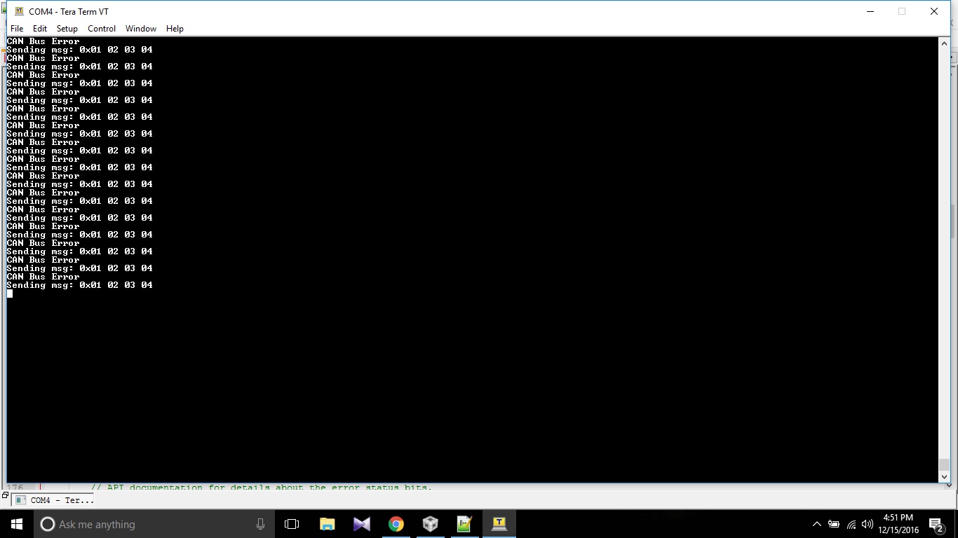

Hello people, I am new to code composer studio. I am learning about TM4C1294NCPDT launchpad for my final year project. I have been given a task to interface two launchpads using CAN bus protocol. I have used the simple Tx and Rx example codes for CAN. For hardware I have used two MCP2551 ICs with 120 ohm Resistors. But I am not able to send messages from Tx to Rx sides. Moreover, nothing is displayed in the console on either sides. I am attaching an image of my circuit diagram and also the Rx and Tx code files that I am using. Your help and guidance would be highly appreciated. Thank you.

    		if(errFlag) { // check for errors
    			UARTprintf("CAN Bus Error\n");
    	return 0;
  • Hello Kunal,
    Can you check the variable "status" to see what is the Error?
  • Hello Amit sir. I tried to check the status variable in debug mode of code composer studio. But it doesn't display the status variable in the list. I am attaching a screenshot of the CCS environment that shows the list of all variables. Moving further, I tried to look up for CAN_INT_INTID_STATUS because when the status variable is equal to this value(Line no. 29 in our code), the error flag is set. CAN_INT_INTID_STATUS is located in hw_can.h file and its value is equal to 0x00008000. So I think that the value of the status variable is 0x00008000. It is supposed to be 1 in order to transmit the message.  I am also attaching the screeshot of hw_can.h file.  CAN_INT_INTID_STATUS is at the line no. 153.
    Also would you please explain us by uploading a video of how to interface two boards using CAN bus protocol? That way, we might get to know what is the problem.
  • Hello Kunal,
    Can you please provide the CCS projects for the CAN Rx and Tx so that I can reproduce the issue on my test board. Not just the files but the CCS projects. Please do note that I don't use the CAN transceiver that you have.

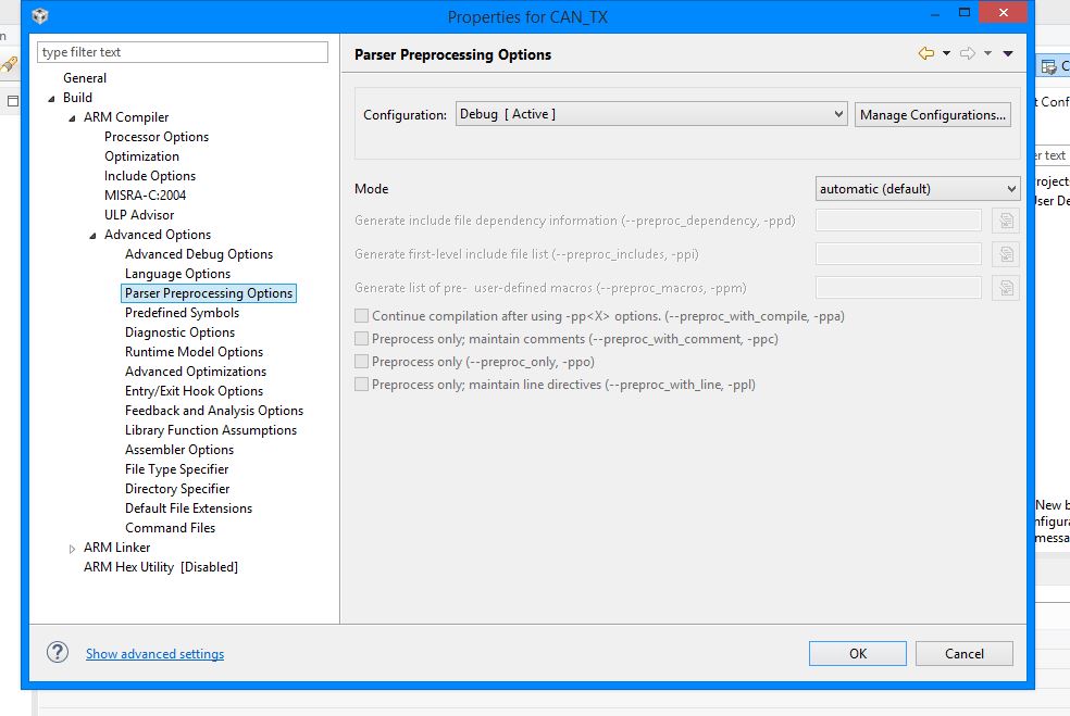

  • Hello Kunal
    And what is the define set to as during compilation option?
  • Sir, we don't understand what you are asking for. Can you be more specific about what you were asking?
  • Hello Amit sir,
    We have used On board LED to check whether the transmitted data is received properly or not.
    As shown in attached file , our program does not execute the 'if loop'.
    That means ' g_bRXFlag ' has to be set , but in this case it does not set. Therefore at receiver side the On-Board LED doesn't TURN ON and hence the transmitted message is not received.

  • Hello Dhruvil,
    I mean what is the define TARGET_IS_TM4C129_RAx (X being 0, 1 or 2) being set in the project properties?
  • Hello Amit sir,
    This is for TX code :
     #if defined(TARGET_IS_TM4C129_RA0) ||                                         \
       defined(TARGET_IS_TM4C129_RA1) ||                                         \
       defined(TARGET_IS_TM4C129_RA2)
       uint32_t ui32SysClock;
    #endif

    Right click your CCS project, Go to build Settings, then in the pop-up, Compiler->Advanced Setting-> Pre Processor.
    I guess based on your response I gather that you have not set any properties for the project?

    i can't fine any option like pre-processor in Advanced option.
  • Hello Dhruvil,
    Look under Predefined Symbols. There would already be the PART_ define in the options. Add the above mentioned define.

    Thank you for your suggestion. We have checked on our board, It is TM4C1294NCPDTI3 written. So, we have added TARGET_IS_TM4C129_RA2 in pre-defined symbols and put ","  at the error location so that we are able to remove the errors.
    But, as shown below in the photo, the data is continuously transmitted, but at receiver side, there is no data received.

  • Hello Khush

  • and the errors i am getting are
    unresolved symbols
    Description Resource Path Location Type
    make: *** target pattern contains no '%'. Stop. subdir_rules.mk /can/Debug/utils line 6 C/C++ Problem
    error encountered linking file
  • Hello Ashwini,
    Can you please open a new post along with the project so that I can check on my CCS setup?
    NOTE: A new post....
