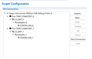

In my project I have 2 TM4C129 MCUs and daisy chained JTAG connection.
So I am trying just to create a project with empty main() functions and debug it. When I am trying to debug second MCU, I got errors:
CORTEX_M4_0: GEL Output:
Memory Map Initialization Complete
CORTEX_M4_1: GEL Output:
CORTEX_M4_1: Trouble Setting Breakpoint with the Action "Terminate Program Execution" at 0x244: (Error -1066 @ 0x244) Unable to set/clear requested breakpoint. Verify that the breakpoint address is in valid memory. (Emulation package 9.3.0.00042)
CORTEX_M4_1: Trouble Setting Breakpoint with the Action "Finish Auto Run" at 0x248: (Error -1066 @ 0x248) Unable to set/clear requested breakpoint. Verify that the breakpoint address is in valid memory. (Emulation package 9.3.0.00042)
CORTEX_M4_1: Trouble Removing Breakpoint with the Action "Finish Auto Run" at 0x248: (Error -2044 @ 0x248) Internal error: Requested breakpoint does not exist. Restart the application. If error persists, please report the error. (Emulation package 9.3.0.00042)
No such errors for first MCU. Code seems to be loaded to second MCU OK, and if I debug it with F5 key I am able to get to main(), but F6 key produses an error. My target configuration is:
And its source:
<?xml version="1.0" encoding="UTF-8" standalone="no"?>
<configurations XML_version="1.2" id="configurations_0">
<configuration XML_version="1.2" id="Texas Instruments XDS100v2 USB Debug Probe_0">
        <instance XML_version="1.2" desc="Texas Instruments XDS100v2 USB Debug Probe_0" href="connections/TIXDS100v2_Connection.xml" id="Texas Instruments XDS100v2 USB Debug Probe_0" xml="TIXDS100v2_Connection.xml" xmlpath="connections"/>
        <connection XML_version="1.2" id="Texas Instruments XDS100v2 USB Debug Probe_0">
            <instance XML_version="1.2" href="drivers/tixds100v2cs_dap.xml" id="drivers" xml="tixds100v2cs_dap.xml" xmlpath="drivers"/>
            <instance XML_version="1.2" href="drivers/tixds100v2cortexM.xml" id="drivers" xml="tixds100v2cortexM.xml" xmlpath="drivers"/>
            <platform XML_version="1.2" id="platform_0">
                <instance XML_version="1.2" desc="Tiva TM4C1294KCPDT_0" href="devices/tm4c1294kcpdt.xml" id="Tiva TM4C1294KCPDT_0" xml="tm4c1294kcpdt.xml" xmlpath="devices"/>
            <instance XML_version="1.2" desc="Tiva TM4C1294KCPDT_1" href="devices/tm4c1294kcpdt.xml" id="Tiva TM4C1294KCPDT_1" xml="tm4c1294kcpdt.xml" xmlpath="devices"/>
                <device HW_revision="1" XML_version="1.2" description="" id="Tiva TM4C1294KCPDT_1" partnum="TM4C1294KCPDT" simulation="no">
                    <router HW_revision="1.0" XML_version="1.2" desc="CS_DAP_1" description="CS_DAP Router" id="CS_DAP_0" isa="CS_DAP">
                        <subpath desc="subpath_1" id="subpath_0">
                            <cpu HW_revision="1.0" XML_version="1.2" desc="CORTEX_M4_1" description="Cortex M4 CPU" deviceSim="false" id="CORTEX_M4_0" isa="CORTEX_M4">
                                <property Type="numericfield" Value="0x0" id="TraceDeviceId"/>
                            </cpu>
                        </subpath>
                    <property Type="numericfield" Value="0x0" id="DAP TAP ID"/>
                    </router>
                </device>
            </platform>
        </connection>
    </configuration>
</configurations>
Any suggestions?
