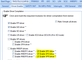

I am facing a problem with halcogen generation for SPI. I have selected SPI1,3,5 in Halcogen --> Driver enable.
When I generate the code it is showing the following error. Can you please let me know what can be the issue. I need to use SPI only and not MIBSPI .

    Please double check to make sure the SPI1/3/5 are selected:
    If SPI1/3/5 are selected, the HALCOGen won't generate source for MibSPI (mibspi.c).
  • Thank you for your reply. Identified the problem was when I switched from MIBSPI1 configuration  to SPI configs in halcogen, the earlier generated functions related to MIBSPI1 still present and definitions were not deleted and as a result compilation error was occurring.
    Ideally if I unselect and option it should delete the functions and pre-processor directives related to that , right ? Just a thought.
    I manually deleted and regenerated with SPI options. Now it compiles successfully.
