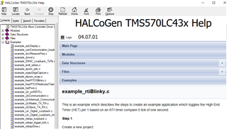

  • Hi Junyoung,
    There is a LED blinky example in AHLCOGen Help topics.
  • Hi QJ
    thank you for reply.
    this guide is very helpful for me.
