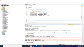

I was running this example https://training.ti.com/hercules-how-tutorial-12bit-adc?cu=1136292 with the launchpad LAUNCHXL2-TMS57012 in halcoGen and CCS software. But, I am getting while run the example code.
Please tell me what I need to change in my halcoGen project and CCS project.
>> Compilation failure
source/subdir_rules.mk:9: recipe for target 'source/sys_main.obj' failed
"../source/sys_main.c", line 90: error #19: extra text after expected end of number
"../source/sys_main.c", line 90: error #110: expression preceding parentheses of apparent call must have (pointer-to-) function type
2 errors detected in the compilation of "../source/sys_main.c".
gmake: *** [source/sys_main.obj] Error 1
gmake: Target 'all' not remade because of errors.

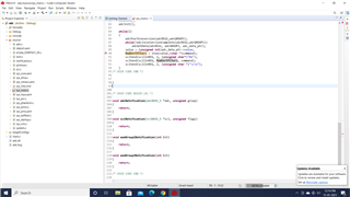

Main code
/* USER CODE BEGIN (0) */
#include "reg_adc.h"
#include "reg_sci.h"
#include "sci.h"
#include "adc.h"
#include "stdlib.h"
/* USER CODE END */
/* Include Files */
#include "sys_common.h"
#include "system.h"
/* USER CODE BEGIN (1) */
unsigned char command[8];
/* USER CODE END */
/** @fn void main(void)
* @brief Application main function
* @note This function is empty by default.
* This function is called after startup.
* The user can use this function to implement the application.
/* USER CODE BEGIN (2) */
/* USER CODE END */
void main(void)
/* USER CODE BEGIN (3) */
adcData_t adc_data;
adcData_t *adc_data_ptr = &adc_data;
unsigned int NumberOfChars, value;
sciInit();
adcInit();
while(1)
adcStartConversion(adcREG1,adcGROUP1);
while(!adcIsConversionComplete(adcREG1,adcGROUP1))
adcGetData(adcREG1, adcGROUP1, adc_data_ptr);
value = (unsigned int)adc_data_ptr->value;
NumberOfChars = 1toa(value,(char *)command);
sciSend(scilinREG, 2, (unsigned char*)"0x");
sciSend(scilinREG, NumberOfChars, command);
sciSend(scilinREG, 2, (unsigned char *)"\r\n");
/* USER CODE END */
/* USER CODE BEGIN (4) */
void adcNotification(adcBASE_t *adc, unsigned group)
return;
void sciNotification(sciBASE_t *sci, unsigned flags)
return;
void esmGroup1Notification(int bit)
return;
void esmGroup2Notification(int bit)
return;
/* USER CODE END */
  • NumberOfChars = 1toa(value,(char *)command);
    The error is that in the above 1toa is used (starts with a one, where instead ltoa should be used (starts with an ell). I.e. try changing the line to:
    NumberOfChars = ltoa(value,(char *)command);

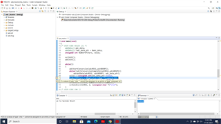

  • I tried changing that statement but getting the follwoing errors.
    >> Compilation failure
    "../source/sys_main.c", line 90: error #167: too few arguments in function call
    "../source/sys_main.c", line 90: warning #515-D: a value of type "char *" cannot be assigned to an entity of type "unsigned int"
    1 error detected in the compilation of "../source/sys_main.c".
    **** Build Finished ****

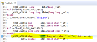

  • "../source/sys_main.c", line 90: error #167: too few arguments in function call
    The screenshot shows TI ARM compiler v20.2.4.LTS is used.
    Handling the Change in ltoa explains that starting from TI ARM compiler v19.6.0.STS a 3rd argument was added to the ltoa function, and the referenced page gives some guidance on how to the change the code.
    Do you want the output displayed as a decimal or hexadecimal value?
    The outputting of "0x" before the command suggests a hexadecimal value.
    If you want want hexadecimal specify a radix of 16:
    NumberOfChars = ltoa(value,(char *)command, 16);
    Or for decimal specify a radix of 10:
    NumberOfChars = ltoa(value,(char *)command, 10);

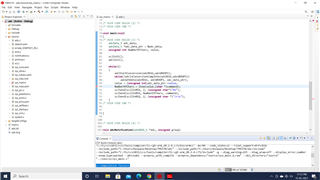

  • Hi Sakthi,
    I think the func is ltoa(..) rather than 1toa(..). As Chester said, 3 arguments are required for ltoa(..) function.

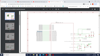

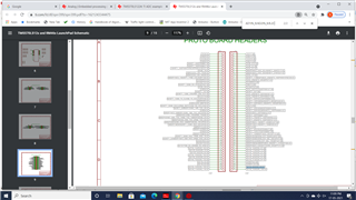

  • This error have gone now Wang. Now it is showing a warning and when I  dump the code to my launchpad i am not getting a proper output on the terminal screen.
  • I had given a PWM of 62Hz to the ADC Pin 9 which mapped to PIN49 on the J11. But, the terminal doesn't show the digital equivalent value.
  • it is showing a warning
    The return value of ltoa() is char rather than int. Did you get correct sampled adc value: adc_data_ptr->value?
