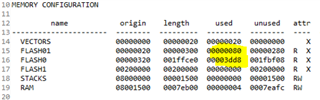

Hi
When I use #pragma to place a specific function in user defined section, the code size increases. Being a linker directive, it is not clear why the code size increases and is there a way to avoid to place the code without increasing the code size
Example:
#pragma CODE_SECTION(SPI_TransmitData,"USER_DEF_SEC")
BOOLEAN SPI_TransmitData(SPI_CHANNEL_ENUM SPI_Channel, UINT16 TxData)
Please help.
Jai
  • HI Jai,
    It should not increase the code size.
    Just did a test to show you that putting some code to other section doesn't increase the code size.
    1. Using #pragma to put test() in .USER_DEF_SEC
         section .USER_DEF_SEC is mapped to FLASH01
         Total code size: 0x080 + 0x3dd8 = 0x3e58

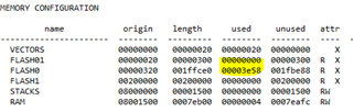

    2. don't use .USER_DEF_SEC for test()
        code size is 0x3e58 which is exactly same as #1
