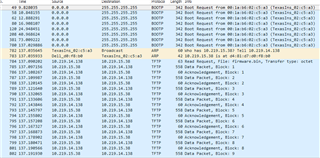

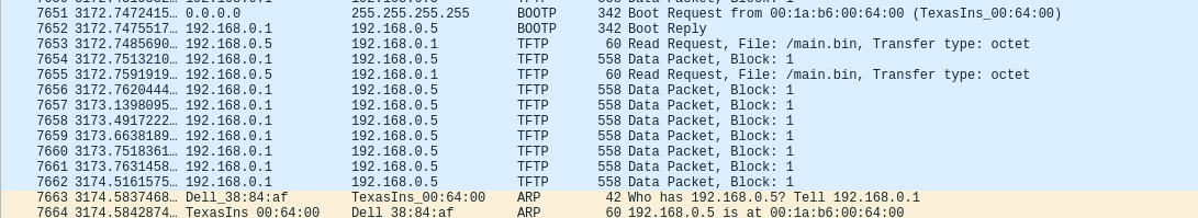

TM4C1294KCPDT: Ethernet bootloader does not get a UIP_NEWDATA flag.
Part Number: TM4C1294KCPDT
Other Parts Discussed in Thread: EK-TM4C1294XL
Recently, I have started to work with TM4C1294KCPDT board and trying to create an Ethernet bootloader for it. I am working on Linux Mint 20.1 Cinnamon using ARM-USB-OCD-H and VS Code for debugging.
After some time of learning basics, I have reached the point, when Ethernet bootloader uses BOOTP and successfully gets IP for the board. Then, it sends a request for a first block of data to TFTP server. Server responses with the first block and here I got a problem. At this point, TFTP server continues retransmitting the first block and bootloader does not process it.
I have noticed that this block of data is actually inside receive descriptor, but the flag is in UIP_POLL state. Moreover, it becomes more weird for me when the connection is aborted(timeout event occurs), bootloader is able to reconnect using BOOTP, where the same UIP_NEWDATA flag is up with a BOOTP data package from the server. The following request from TFTP server is transmitted again, but once again received the first block of data comes without UIP_NEWDATA flag.

  • Hi Mark,
      There is a readily available Ethernet bootloader example in TivaWare library. Please refer to C:\ti\TivaWare_C_Series-2.2.0.295\examples\boards\ek-tm4c1294xl\boot_emac_flash (this is a bootloader) and C:\ti\TivaWare_C_Series-2.2.0.295\examples\boards\ek-tm4c1294xl\boot_demo_emac_flash (this is an Ethernet application that is to be loaded by the bootloader). I wonder if you had a chance to run these examples.
      Based on your Wireshark capture, all I can tell is that the client (the MCU) is not acknowledging the server after it receives the data. Below is what you would have seen if you try the TivaWare example as is. Can you please try the TivaWare bootloader as is without modification? This way you can compare your own bootloader with the TivaWare example.
    I have already tried to launch example projects, but it still requires quite a lot of modifications such as correct memory allocation, buffer size, system clock frequency and more. Therefore, I cannot use default code on my board. Also, I haven't changed functions themselves (only variables), so I tried to leave the code closer to original. Moreover, I am not sure that my code(and default one) has ACK response to the server, but here comes the problem with the flag as well. Even if descriptor contains full content of the 1st data block, it is not able to update the flag, so uip won't process it.
    I have some questions.
    Are you saying if you run the TivaWare bootloader example on the LaunchPad, it also doesn't work, meaning you are not seeing the ACK response packet sent by the client? I have just tried the TivaWare bootloader example on the LaunchPad and it is working as expected for me.
    Are you using the LM Flash Programmer ( which is PC based tool) to download the code?  Or you have your own download tool?
    Does your server machine have multiple NIC? If yes, can you disable some of them so that only one NIC is active.
    I suppose you are running your code on your custom board? Is this correct? Can you try your bootloader on the LaunchPad? Does it have the same problem?
    Can you try the TivaWare example on your custom board? What does it show?
    If you can get the as-is TivaWare bootloader example to run on the LaunchPad, then I hope you can compare the difference between your own bootloader on your custom board and the TivaWare example on the LaunchPad.

  • Hello.
    I have finally been able to test 'C:\ti\TivaWare_C_Series-2.2.0.295\examples\boards\ek-tm4c1294xl\boot_emac_flash' example. It works perfectly on my board. It seems that I have a problem somewhere in the code. Unfortunately, bootloader example does not provide source files (only configuration and executable files), where I might compare functions with mine version of ethernet bootloader. Is it possible to see the real code working behind the final .bin file?
    Update. I checked Makefile and saw that booloader is using the whole 'C:\ti\TivaWare_C_Series-2.2.0.295\boot_loader' directory.

  • I am working via terminal commands. I have done the following things:
    1)Erased all data from microcontroller using openOCD
    2)Uploaded '.../examples/boards/ek-tm4c1294xl/boot_emac_flash/gcc/boot_emac_flash.bin' file via openOCD
    3)Check if program was uploaded via boot loader(simple program with blinking LED). In my case, it works fine.
    4)Rebuilding ''.../examples/boards/ek-tm4c1294xl/boot_emac_flash/' project using Makefile in this directory
    5)Repeating step 1-2
    6)Checking Wireshark for Ethernet communication. It doesn't do anything. Hence, rebuilt boot loader does not work anymore.
    I have rechecked flags in Makefile and do not see anything that should be fixed.
