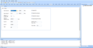

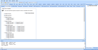

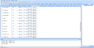

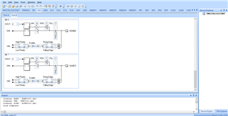

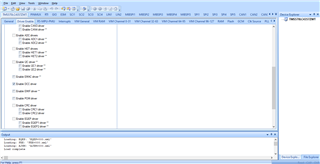

Steps I followed after reading the manual and the questions from the forum to inject DCC error and check the ESM functionality:

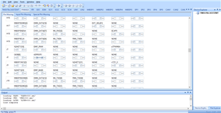

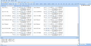

Halcogen configurations:
Code:

I am testing some code that monitors the ESM flags in group 1. With this error, the pin state is always high.
How can I inject DCC error OR in ESM?

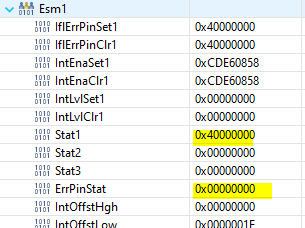

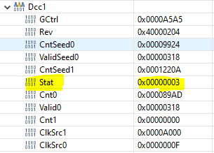

  • Just did a test. I use OSCIN as cnt0 clock source, and PLL1 as cnt1 cock source. OSCIN=16MHz, and PLL1=300MHz
    cnt0 seed is 39204  ----> 39204*300/16 = 735075
    cnt0 valid is 792       ---->(39204+792)*300/16 =  749925
    The cnt1 see should be between 735075 and 749925
    If  cnt1 seed = 742500, test passes without error
    If  cnt1 seed is 74250 which is out of the range (735075, 749925), the test failed:
    1. ERR bit is set
    2. ESM 1:30 is set

  • This is the status of error pin. The error pin is pulled low.
