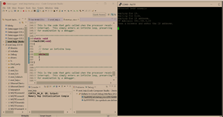

After 2,3 days I am getting the issues while debugging these project , I run my project it goes into NMI ISR and the Fault ISR.
I debug enet_lwip example code also then also I am getting same issues going in Fault ISR.

    also I have gone through the document i got the NVIC_FAULT_STAT register address 0x00008200  that is PRECISE and BFARV bits are set. but I am no getting how to resolve this issue . I have tried the solution as given in the document . but It is not resolving my problem.
    Can you provide the Address you are getting inside of the Bus Fault Address Register (FAULTADDR) register?
