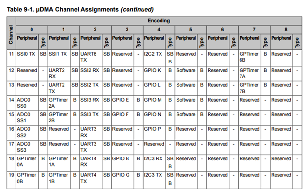

Hello Team,
We are working on UART3 receive with uDMA with EK-TM4C1294XL(Launchpad) as Master and MSP430FR2355 as salves(which receives packets from TM4C and Send to TM4C). So, I have Configured UART3 for uDMA Receive channel Also we are using RS485 for Tx and Rx in between Master and Slave but whenever i kept a breakpoint at uDMA receive step data is getting byte by byte. But at Free Run No data is getting to my internal Buffer. Why is this happening as previously also i faced this type of problem when Using TM4C(Launchpad) and MSP430FR2355(Launchpad) using UART0. But same type of Configuration we have used for UART3 Now. Is there any changes in UART3 to UART0 added RS485 in design ? Please Help me to Resolve Issue. I'm facing lot of issues in uDMA. Can anyone please clarify me why it is happening like this.?Any help would be very thankful.

As Above image UART3 & channel 16,17 is at peripheral2
Above Image given UART0 & channel 8,9 as peripheral 0.
Comparing to UART0 , am i making mistake in configuration of UART3 Receive with uDMA or may i use same configuration ;ile UART0 receive with uDMA ? Please refer to the code and guide me in a right direction to receive data using uDMA.
  • One difference between UART0 uDMA and UART3 uDMA is that uDMA channel 8 is the default channel for UART0 RX, but uDMA channel 16 is not the default channel for UART3 RX. Therefor you must include a call to uDMAChannekAssign(UDMA_CH16_UART3RX);
  • Thank you for the reply Bob,
    Good Info, I have Included "uDMAChannekAssign(UDMA_CH16_UART3RX);" in configuration but there is no change. If that is the only issue, need to get data but no data came into my internal buffer. Am i missing something more ?

  • Have you verified that UART3 is working with a simple polled routine? If you have, then export your entire project to a .zip file and attach it to this thread. I will then look at it.
  • Yes Bob,
    I have tried that and In this Process also i'm Receiving Byte by Byte when i Kept/Use a Breakpoint at Function Also Received Byte Replacing with the New Byte in My Internal Buffer(gu8Array) i uased a breakpoint at Function below

    Please check and Update me Bob. Any help to resolve this issue would be very Thankful. In this we are using RS485 to Communicate with our MSP430FR2355 Customized Board.
  • There were several issues in the code you provided. I will only summarize the modifications I had to make because I do not have your hardware.
    Since I don't have a device which will respond to the packet you sent, I used loopback mode. Line 231 in main.c enables loopback mode.  I also changed the number of bytes to receive to
      sizeof(gu8Array) >> 1u
    because each transfer was transferring two bytes.
