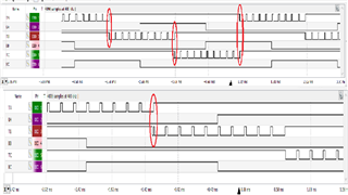

Hello, my project idea is to rotate a BLDC motor by imposing a certain duty cycle value (which I change with Launchpad buttons) and setting a period value (in this case 1 ms) that allows me to make transitions between 6 states where in each state a high transistor and a low transistor are turned on at the same time while the other 4 transistors are turned off. The transitions are as follows:
State 1: high transistor of phase A and low transistor of phase B are on.
State 2: high transistor of phase A and low transistor of phase C are on.
State 3: high transistor of phase B and low transistor of phase C are on
State 4: high transistor of phase B and low transistor of phase A are on
State 5: high transistor of phase C and low transistor of phase A are on
State 6: high transistor of phase C and low transistor of phase B are on
For the high transistors I have applied a PWM type signal and for the low transistors a GPIO signal that is simply held high or low, all depending on the state. My problem is that, although the transitions are done correctly (as I have been able to observe in the Analog Discovery that I use to visualize the time signal), I get a certain Jitter that makes me overlap transistor switching that should not be seen, marked with red circles in the image (as they belong to different states) and that, therefore, would cause that if I connect the motor there may be moments of time when I have 4 transistors working and will cause me big problems. To sum up, I would really like that there would not be any possibility of transistors overlapping between states and maybe even that there would be a certain short delay to make sure of it at each transition, but I can't think how to do it. I copy my code in case someone is able to tell me where the failure could be or what solution could solve it. Thanks in advance.
How transitions should be:
What I am getting on the Analog Discovery:
My code is the following:

  • Hello Alex,
    As you have noticed, the exact timing of the switching signals is quite important to these motor drive applications.  I'm not an expert on them myself, and most our customers use a DRVxxx motor drive chip in between the MSP430 and the motor.   I know that C2000 have devices specifically designed for these types of control applications, and have high-performance PWM generators.
    As for the glitches you are seeing, My best guess is that that may come from changing the CCRx registers.  The MSP432 doesn't have buffered CCRx registers as far as I'm aware, so the CCRx changes will happen in real time, which can sometimes cause glitches in the outputs depending on where the timer counter is.  As a test, could you try stopping the timer while you update the CCRx registers and then start it again?  (I know this may slow/stretch your overall timing, but may help narrow down the root cause.)
    JD
