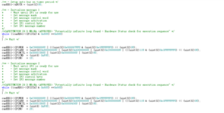

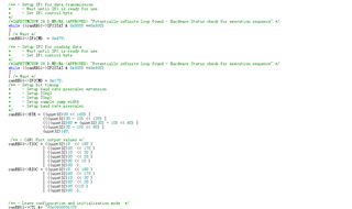

    The picture shows my register configuration. This configuration refers to a project on the forum. This example is configured as you said. I don't know where there is a problem with this configuration. Caused the problem I mentioned earlier.
    These pictures are CAN1 register configuration

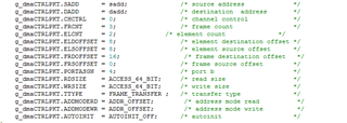

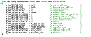

    This picture is IF3 and DMA configuration.
    This picture is the DMA buffer size configuration. I modified the size of element count but it didn't work. It still enters the DMA interrupt after only one frame of data is received.

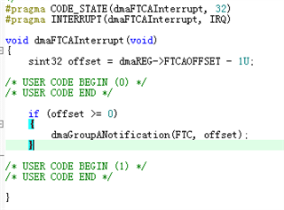

    This picture is the DMA interrupt function. This function is only triggered once. Sending data to MUC for the second time will not enter this interrupt.

  • In your setup, the message object 2 is configured to update automatically. The DCAN core will check the NewDat flag of msg object 2. If this flag is set, which means msg object received a new message,  the message will be transferred to IF3x  registers.
    If IF3 update is complete, a DMA request is generated. The DMA request stays active until first read access to one of the IF3 registers. The DMA functionality has to be enabled by setting bit DE3 in DCAN Control register.
    Please double check if DE3 in CTL register is set:
    // Enable DE3 bit in CTL register to trigger DMA when IF3 receives data
     canREG1->CTL |= (1U << 20U);

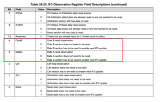

    On the first picture I set up this register during CAN initialization. Do I need to re-initialize it? I found that the data in the DCAN IF3OBS register is 0x00000018 after entering the interrupt. Is it necessary to read a register to clear this flag so that the interrupt can be triggered again?
    The value of the DCAN IF3OBS register after entering the interrupt.
    Should this register be cleared?What should I do to clear this flag bit?
  • Sorry for skipping the first snapshot yesterday. The IF3OBS will not be cleared after the message is moved to IF3 registers.

    This is my configuration.
    I want to trigger an interrupt after receiving 3 frames of data, but it did not succeed.
  • I don't understand your DMA package settings. Please use the original DMA package settings and change the FRCNT to 3.
    For CAN TX side, please transmit 3 packages.
