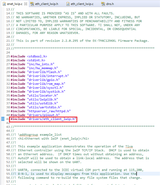

I have trouble  when trying to use TivaWare_C_Series-2.2.0.295 SDK eth_client_lwip.h library in enet_lwip example project:

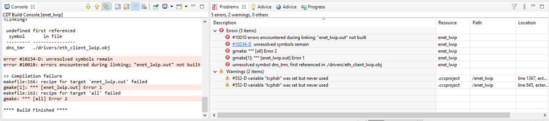

The problem is, when I link eth_client_lwip.c library source code to enet_lwip project and compile, I get this error:
dns_tmr() function is from dns.h library which is included in eth_client_lwip.h. Form error it seems that eth_client_lwip.h can't find dns.h source code. Even when I link dns.c library source code to project, the error remains. I looked for working solution on the internet, but with no luck.
The way I link eth_client_lwip.h and dns.h libraries source codes to project is the same: right-click on project -> Add files... -> Link (locations relative to SW_ROOT). An then move linked files to created respective folders in project directory:

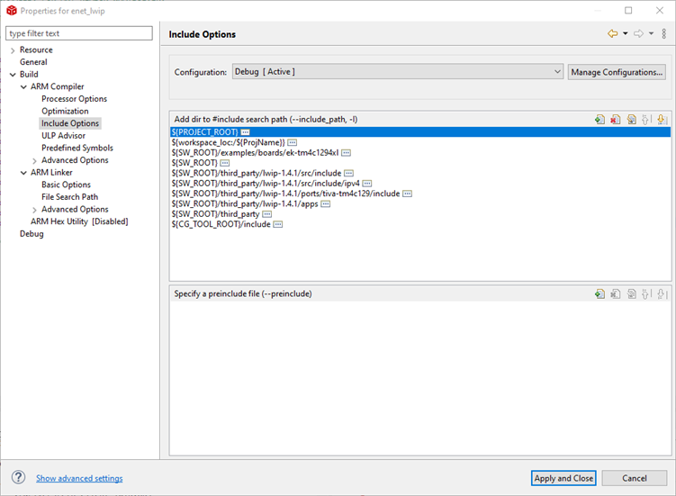

Compile include options:
Linker file search path:

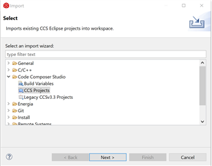

    I suggest starting over. Rename or delete your existing project then import the project with "File" -> "Import". Use the wizard to select "CCS Projects"
    Then select the directory "C:\ti\TivaWare_C_Series-2.2.0.295\examples\boards\ek-tm4c1294xl\enet_lwip"
    For me, the project builds without errors.

  • Probably because you did not edit opt.h and enable LWIP_DNS on line 818. If you open dns.c in Code Composer and all the lines are in a grey outline starting on line 77, #if LWIP_DNS, then it means LWIP_DNS is still 0.
