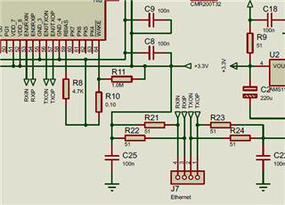

  • The joy was premature. Everything works on EK-TM4C1294XL, but on my PCB bootloader does not want to work. Moreover, the problem is curious: I started bootloader through the debugger, clicked the "Programm" button in LM Flash Programmer and UDP sniffer. LM Flash Programmer sends packets 72 bytes long, and bootloader catches packets 76 bytes long (Although the contents of the packet are correct. Checked in the uip_buf variable). As a result, the bootloader is constantly spinning in a loop that starts on line 1783 (if(!(g_psRxDescriptor[g_ui32RxDescIndex].ui32CtrlStatus & DES0_RX_CTRL_OWN))). What could be the problem?
      Really don't know what went wrong when you said it is fully working on the LaunchPad. Are you sure it is exactly the same bootloader and application firmware that are running on the custom board?
      I will suggest you check a few things.
      - Do you have the 25Mhz OSCIN on the custom board?
      - Do you have the MAC address programmed on your custom board? For experiment, why don't you program the same MAC address for the LaunchPad on your custom board? Does it make a difference?
      - If you start your custom board MCU with only the bootloader and no application, will it bootload at least once? I just wanted to know if it will bootload once. Or Is it only that the subsequent "Program" from the LM flash Programmer fails?
      - On the wireshark, where is the difference between the LaunchPad and your custom board?
  • Yes, I downloaded the same bootloader from the same computer on LaunchPad and PCB. I did not change the bootloader itself between downloads to the devices.
    - Yes, the PCB is 25MHz OSCIN.
    -In my answer above, I described how I set the MAC address and in sniffer I see that LaunchPad actually uses this MAC address.
    - While the LaunchPad is flashed as many times as you want, the PCB (after pressing Programm) does not show any signs of life, and the LM Flash Programmer hangs indefinitely in the state of Attempting to connect.
    - In sniffer, the difference between LaunchPad and PCB is visible - the latter does not give an answer to port 67.
      Did you resolve the problem? Did you make sure there is only one NIC on your PC? How long did you wait to claim that it is not working. The reason I asked is because the client does not send BootP request periodically but rather in increasing duration to avoid jamming the network. If you look at the below capture the client sends BootP request the first time and if it didn't receive a response from the server, it will wait for 1 second before sending the next request. If it still doesn't receive response then it will wait 2 seconds before sending the next request. As you can see, it will wait 1s, 2s, 4s, 8s, 16s, 32s and 64s before sending the BootP request. If you happen to press the "Program" button when the client just send its request, the server may need to wait up to 64 seconds before the client sends its next request. You may think that it is not working but if you wait long enough (longer than 64 seconds) it should come through.
  • Hi, nope i didn't. Yep, i have the one and only NIC (i checked output packets in Wireshark). I waited for 30 mins, so i don't think this is why bootloader didn't work on my PCB. I guess, problem is hardware. This is the one and only difference between my PCB and Launchpad (which bootloader works properly)
  • Does the custom board still work for other Ethernet examples?
    Can you share your schematic at least for the Ethernet portion?
    Can you share the wireshark captures for running on the LaunchPad and custom  boards?
  • 1) Yes, still work
    2)
    3) I'll share it later
  • Looking at the schematic, we don't see the isolation transformer or the protection diodes. Are they integrated in the RJ45 connector? Still does not explain why other applications work and but the bootloader does not. Let us know when you have the wireshark captures.
