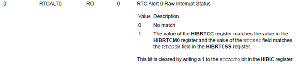

    Bit 0 of the same Register is for the RTC match interrupt which wakes-up my system from (deep) sleep by the hibernation interrupt as expected:

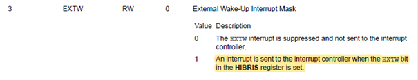

    Interrupts will be forwarded to the interrupt controller if the corresponding mask bits in the Hibernation Interrupt Mask (HIBIM), offset 0x014 are set. The manual describes the bit for /WAKE as follows:

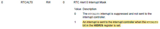

    This is in accordance with e.g. the mask bit for the RTC alert which works well:
    All hibernation interrupts are routed via the NVIC to the same interrupt vector. The fact that the RTC pulls my system out of (deep) sleep and calls my hibernation interrupt service, proves that the interrupt system is configured correct.
    What I find suspicious is, that I never found the EXTW bit set in the HIBRIS register. To me, this explains why no hibernation interrupt occurs and the controller doesn’t wake-up.
    On the other hand, if I hibernate the system, the /WAKE works well and the hibernation interrupt service is called. So I assume that the /WAKE signal is routed correctly. Which is also checked with the scope.
    It seems to me, that in run an sleep modes a ‘link’ between the signal on the /WAKE pin and the EXTW bit in the HIBRIS register is missing.
    Is there a condition not fulfilled, to forward the /WAKE signal to the EXTW bit in HIBRIS?
