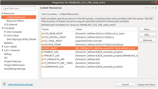

    To set a CCS project which can be used under Windows and Linux performed the following steps in the project configuration:
    1. Under Resource -> Linked Resources add a path variable F021_ROOT with the value ${TI_PRODUCTS_DIR}/Hercules/F021 Flash API/02.01.01 :
    Where the ${TI_PRODUCTS_DIR} directory is C:\ti under Windows and ~/ti under Linux.

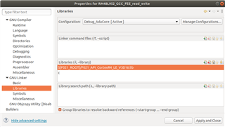

    3. Under libraries add the flash library file relative to ${F021_ROOT} :
    The above example was using a RM48L952 and so the ${F021_ROOT}/F021_API_CortexR4_LE_V3D16.lib library.
    For a TMS570LC4357 would use ${F021_ROOT}/F021_API_CortexR4_BE_L2FMC_v3D16.lib
