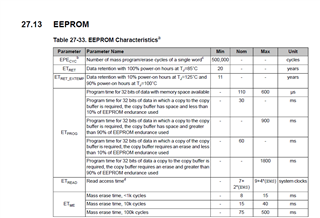

      You cannot use flash to replace RAM. The flash is a non-volatile memory. You cannot just write to it like writing a RAM. A change of value from 0 to 1 requires a erase to the flash. I will suggest you use the on-chip Emulated EEprom instead. There is 6kB of EEprom on chip. Please bear in mind the number of program/erase cycle the EEprom can support. It is spec'ed in the datasheet.
    uint32_t ui32EEPROMInit;
    uint32_t pui32Data[2];
    uint32_t pui32Read[2];
    // Enable the EEPROM module.
    SysCtlPeripheralEnable(SYSCTL_PERIPH_EEPROM0);
    // Wait for the EEPROM module to be ready.
    while(!SysCtlPeripheralReady(SYSCTL_PERIPH_EEPROM0))
    // Wait for the EEPROM Initialization to complete
    ui32EEPROMInit = EEPROMInit();
    // Check if the EEPROM Initialization returned an error
    // and inform the application
    if(ui32EEPROMInit != EEPROM_INIT_OK)
    while(1)
    // Program some data into the EEPROM at address 0x400.
    pui32Data[0] = 0x12345678;
    pui32Data[1] = 0x56789abc;
    EEPROMProgram(pui32Data, 0x400, sizeof(pui32Data));
    // Read it back.
    EEPROMRead(pui32Read, 0x400, sizeof(pui32Read));
