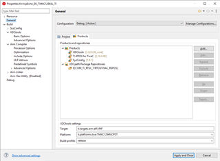

I got a numbers of errors when compile TI-Rtos example tcpEcho_EK_TM4C1294XL_TI.
CCS 10.3.1.00003

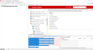

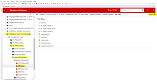

      How did you create the example? Did you "import" the example? Can you try again from CCS TI Resource Explorer?
      1. First delete the existing example.
      2. Go to Resource Explore. See below
      3. Go to the example and click on the "Import" at the upper right. You must do import and never copy files from somewhere.
    4. Once the example is imported to the CCS workspace, you just build it. I just tried it myself and I have no problem building it.
