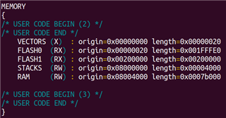

my HL_sys_link.cmd file:
  • During my debugging efforts, I've noticed that depending on the HalCoGen-configured User-Stack size and binary size that this issue presents whenever this CIOBUF section falls above 0x0800_8000.
    The TMS570LS0432 has 32 KB of RAM, between 0x08000000 and 0x08007FFF, as shown by the datasheet:
    The ccs1030/ccs/ccs_base/emulation/gel/tms570ls043x.gel matches the above, which explains why the CCS debugger reports "Invalid CIO command (0). Memory map prevented reading 0x0800970C" :
            GEL_MapAdd(0x08000000, 0, 0x00008000, 1, 1); /* Internal RAM          */
    What caused the HL_sys_link_cmd to set the RAM memory region to be from 0x08004000 to 0x0807EFFF which is beyond the end of the the 32KB of RAM in a TMS570LS0432?

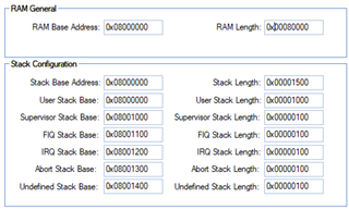

  • Chester - Thanks for looking into this.
    I believe this chip set for the Hercules Launchpad corresponds to SPNU563A which has larger RAM than the configuration you are showing (March 2018 version):
    https://www.ti.com/lit/ug/spnu563a/spnu563a.pdf?ts=1624119072343&ref_url=https%253A%252F%252Fwww.google.com%252F
    For what it's worth, I used the default project created by New > TMS570LC43x > TMS570LC43572WT and it's RAM configuration is shown as:
    MEMORY
    /* USER CODE BEGIN (2) */
    /* USER CODE END */
    VECTORS (X) : origin=0x00000000 length=0x00000020
    FLASH0 (RX) : origin=0x00000020 length=0x001FFFE0
    FLASH1 (RX) : origin=0x00200000 length=0x00200000
    STACKS (RW) : origin=0x08000000 length=0x00001500
    RAM (RW) : origin=0x08001500 length=0x0007eb00
    /* USER CODE BEGIN (3) */
    /* USER CODE END */
    which I believe matches the datasheet. Perhaps it's as simple as updated that GEL file and loading it into CCS?
