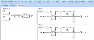

Hi Team,
Did you have any example code for the I2C for RTC real time clock project and the configuration for I2C in HALCoGen?

This is an example for RTC I posted 2 years ago:
Hi QJ Wang,
// Slave address
#define RV3129_ADDRESS 0x56
// Temperature Page
#define RV3129_TEMP 0x20
#define DATA_COUNT 1
/* Transmit Start Condition */
i2cSetStart(i2cREG1);
/* Configure address of Slave to talk to */
i2cSetSlaveAdd(i2cREG1, RV3129_ADDRESS);
/* Set mode as Master */
i2cSetMode(i2cREG1, I2C_MASTER);
/* Set direction to Transmitter */
/* Note: Optional - It is done in Init */
i2cSetDirection(i2cREG1, I2C_TRANSMITTER);
/* Send the Word Address */
i2cSendByte(i2cREG1, Slave_Word_address);
/* Set Stop after programmed Count */
i2cSetStop(i2cREG1);
/* Tranmit DATA_COUNT number of data in Polling mode */
i2cReceive(i2cREG1, DATA_COUNT, RX_Data_Master);
/* Wait until Bus Busy is cleared */
while(i2cIsBusBusy(i2cREG1) == true);
/* Wait until Stop is detected */
while(i2cIsStopDetected(i2cREG1) == 0);
/* Clear the Stop condition */
i2cClearSCD(i2cREG1);
/* Simple Dealya before starting Next Block */
/* Depends on how quick the Slave gets ready */
for(delay=0;delay<100000;delay++);
I have tried this code as per the Hercules I2C example but I did get any output for this RTC
Please help me to prepare the sequence.
Can you confirm me the configuration of I2C and Code ?
