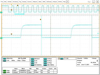

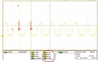

    I got waveform from customer. please see attached below for fast mode SCL.
    I don't think (2) slave's clock stretching or (3) measurement method is a reason of the frequency difference.
    Regarding (1) PLL configuration, customer observes correct frequency of SPI clock(TM4C1294 is master) as expected. so system clock seems properly configured. Customer will confirm this just in case.

  • Hello Bob-san,
    Thank you for your comment. Customer measured OSC1, pin89 and provided below waveform.
    It runs with 16MHz.(Customer mentioned the waveform rounding may be due to probe capacitance and actual waveform may be better than it)
    Could you check this waveform will cause the I2C frequency difference?
    Regarding PLL configuration, customer is now confirming with SW engineer and will give us feedback.
  • The shape of the waveform does not concern me. The frequency looks correct. I will wait for the PLL configuration information.

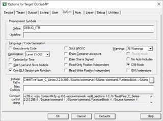

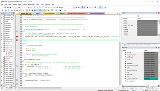

    Customer confirmed PLL configuration below and 120MHz system clock is made from the ext. 16MHz. Return value is 120MHz so customer thinks there is no problem.
    They are using Tivaware version 2.2.0.295.
    Please let me know if you notice anything.

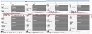

  • Unfortunately I don't have hardware with a TM4C129 device running off of a 16MHz external crystal. Would you ask them to provide the value in the : I2C Master Timer Period (I2CMTPR) register after the I2C is configured?
  • Hello Bob-san,
    Customer confirmed and gave below picture. I2C2 is for 1M(0x5) and others are for 400k(0xE).

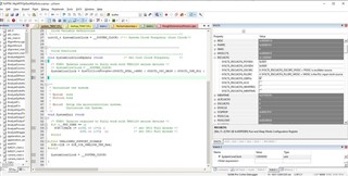

  • Those are the correct values for the master clock time period register. The baud rate is a digital divide of the system clock. It will be as accurate as the system clock. There is no analog skew of the frequency in the clock generation. The only thing I can think of is that even though the SysCtlClockFreqSet() function is correctly selecting the main oscillator, somewhere the PIOSC is switched to the PLL clock source. This can be checked by looking at the value in the RSCLKCFG register. The PLLSRC bits, 27-24, should be equal to 0x3.
  • Hello Bob-san,
    Customer confirmed RSCLKCFG-PLLSRC bit and MOSC is the PLL clock input source. Please see below image.

  • I have been able to duplicate what your customer is seeing. It is clock stretching, but not from the slave. The discrepancy in period is caused by the rise time of the pullup resistor. To the master device, the time between when it releases the clock, and when the pullup resistor brings the clock line to Vih looks like clock stretching and will increase the clock low period. You can verify this by increasing the resistance of the pullup resistor and you will see the SCL period increase.

  • Hello Bob-san,
    Customer observed SCL frequency changes along with pull-up resistor as you mentioned.
    Pull-up resistor[ohm] 470 1.1k 2.4k 4.7k
    Cycle time[us] 1.034 1.052 1.084 1.138
    Frequency[kHz] 967.118 950.5703 922.5092 878.7346
    High time[ns] 436 450 484 546
    Low time[ns] 592 592 592 590
    Rise time[ns]
    (1.14V~2.14V)
    6.4 17 36 80
    What customer see is SCL low period is fixed and High period is changing along with pull-up resistor, while you said Low period will change.
    Is the customer observation correct as the device's clock stretching?
  • Yes, this is clock stretching caused by the rise time of the pullup resistor. I refer to it as the low period being stretched because the master I2C circuit in the device considers it low period until the SCL line rises to Vih. In this case it is the rise time that is actually stretched as the pullup resistance is increased. The time that the master holds SCL low is constant. The time that SCL is above Vih until it goes low again will be constant. The time between when SCL is released and when it hits Vih is what increases.
