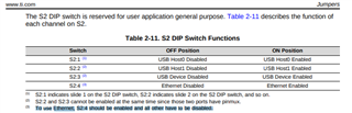

  • I have connected two Hercules TMS570LS31x dev boards which has PHY device DP83640. I used Halcogen code and all my EMAC and MDIO init including PHY link were successful. I have configured for MII mode and the PINMUX are set as per TRM manual section Table 29-3 and Table 29-4.
    If you are using the TMDS570LS31HDK can you check the state of the S2 DIP switch?
    As per the TMS570LS31x Hercules Development Kit (HDK) User's Guide (Rev. C) to use Ethernet S2:4 should be ON, and S2:1 / S2:2 / S2:3 be OFF:
    Looking at the TMDS570LS31HDK schematics if S2:4 and S2:1 were both on only some of the DP83640 Rx and Tx MII pins would be connected which may lead to some of your odd errors with the data.
    I assumed the default state of these switches is OFF. So I only changed S2.4 to make Ethernet_ON on both the boards. I need to check if S2.1 was turned on inadvertently.

    Status of S2.1 is OFF
    Jai
    Status of S2.1/2/3 is OFF and only S2.4 is ON.

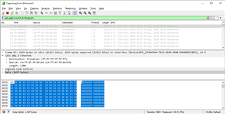

    I don't have a TMDS570LS31HDK, but did try pasting your code into a project for a TMDSRM48HDK which as far I can tell uses the same  DP83640.
    As only have one HDK, connected it to an Ethernet switch to which some PCs were also connected and confirmed that Wireshark running on two connected PCs showed the 100 packets transmitted were received with the expected 1ms interval. E.g.:
    Not that while your original code set the source MAC address as broadcast, I found it appears implementation defined behavior if an Ethernet switch will accept a packet with a broadcast or multicast source MAC address. E.g. found that the 4 port Ethernet switch in my broadband router forwarded packets with a source broadcast MAC address, but a managed D-Link DES-3526 switch didn't.
    Therefore, in the attached program the source MAC address is a randomly allocated locally administered addresses.
    Still not sure why you are getting errors in the Ethernet packets, but perhaps there is an issue with say the pin-muxing selecting in your HalCoGen project.
    RM48L952_ethernet.zip
  • Still not sure why you are getting errors in the Ethernet packets, but perhaps there is an issue with say the pin-muxing selecting in your HalCoGen project.
    As an experiment, took the above working project and on the HALCoGen Pin Muxing tab de-selected the MII_TXD_2 signal.
    In the generated pinmux.c this changed the line:
        pinMuxReg->PINMMR13 =   PINMUX_BALL_J18_MII_TXD_0 | PINMUX_BALL_J19_MII_TXD_1 | PINMUX_BALL_H19_MII_TXEN | PINMUX_BALL_R2_MII_TXD_2;
    To:
        pinMuxReg->PINMMR13 =   PINMUX_BALL_J18_MII_TXD_0 | PINMUX_BALL_J19_MII_TXD_1 | PINMUX_BALL_H19_MII_TXEN | PINMUX_BALL_R2_MIBSPI1NCS_0;
    When the modified project was run with the TMDSRM48HDK connected to a port of a managed switch, the managed switch reported it had received 100 frames with a CRC error.
    So, it is possible for an incorrect pin-mux, i.e. with not all MII signals connected, to introduce errors in the data.
